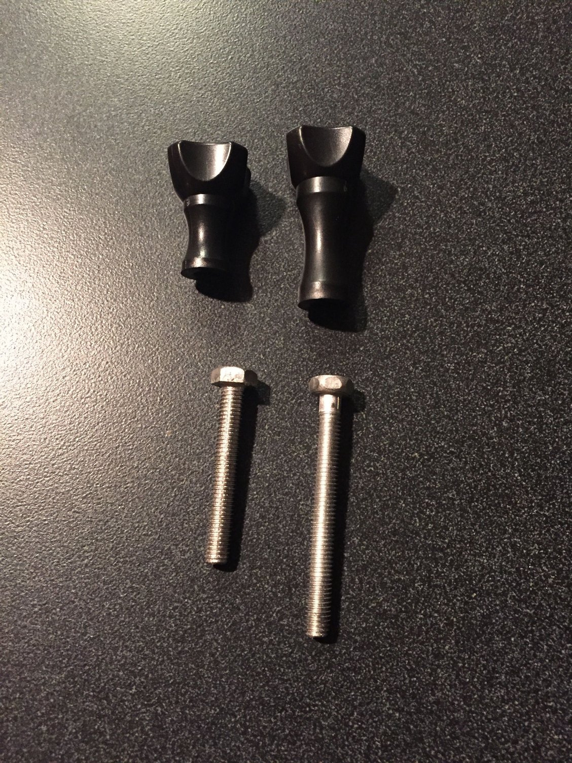

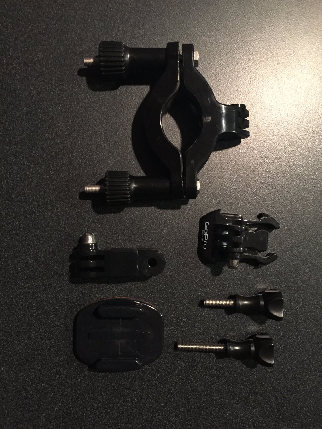

So I came up with a solution to mounting my heat-troller to my handlebars. I didn't want anything permanent, so I decided to use some GoPro mounts that I have. If you don't already have a GoPro or something similar, mounting kits can be found pretty cheap on Amazon. I found a really (overly) complete kit for $15, but rummaged through my kit first and found what I needed. I am using a First Gear remote dual heat-troller. I hope this helps if you have also been looking for a removable solution to mounting a heat-troller. Ride safe and keep the shiny side up!!
Here are all the parts that I used.
There are two different length screws and handles. To make this work I had to switch a long screw to a short handle.

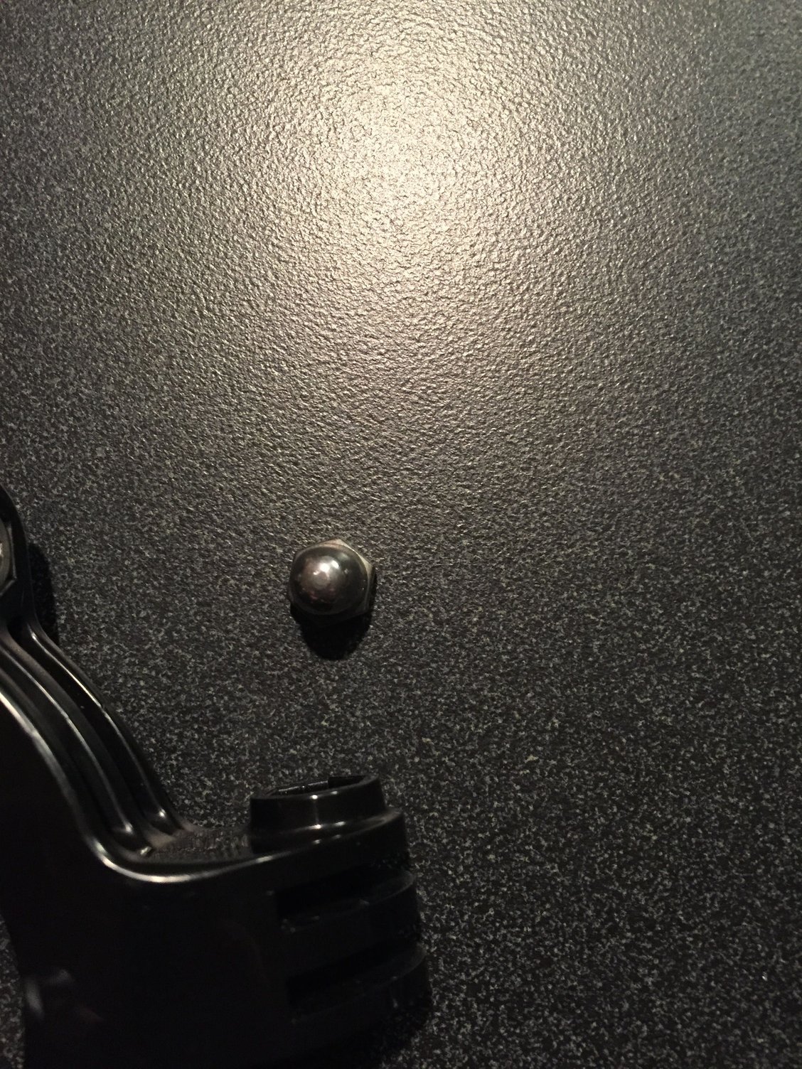

You will need to remove the nut from the bar clamp. This is also where the longer bolt will go.

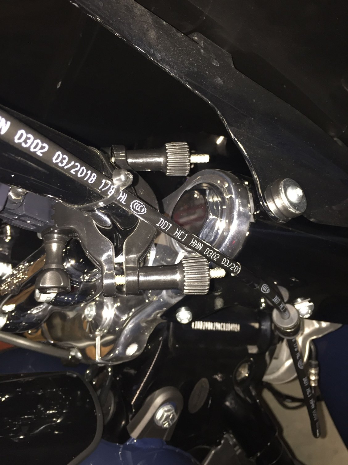

Just a mock up to see how everything fits. I am going to change out some of the longer screws for a cleaner look.
Definitely want to change these, way too long for my taste.

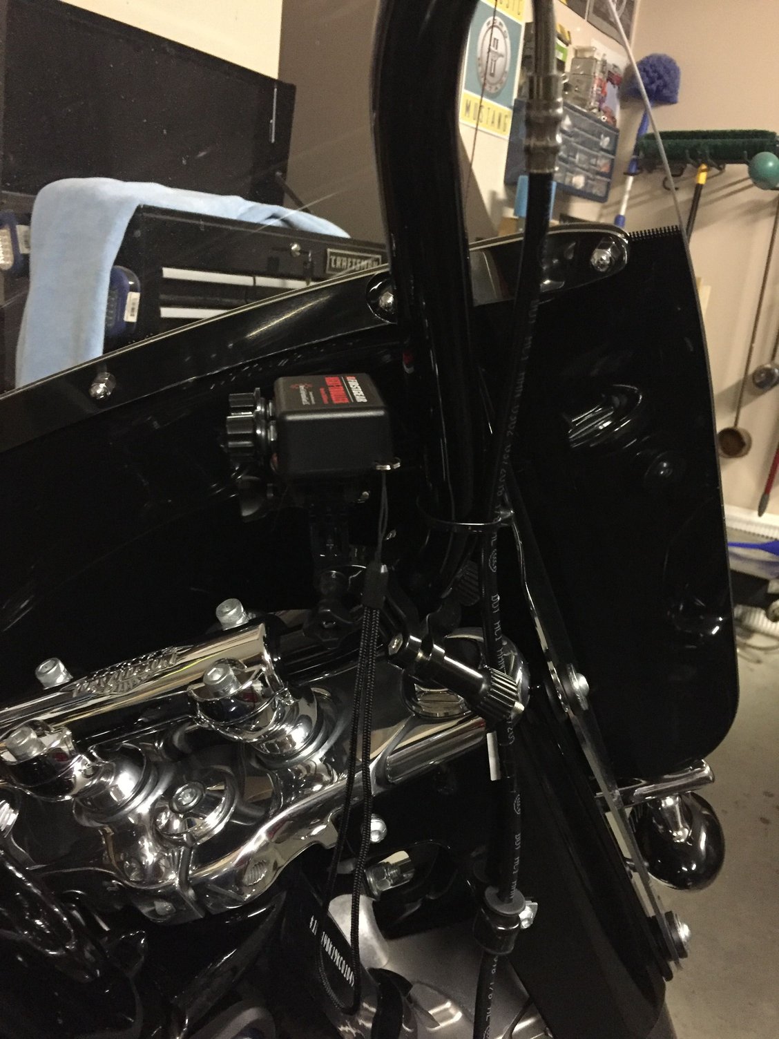

Here's the overall set up. Pretty basic, but you can add more pieces for more adjustability.

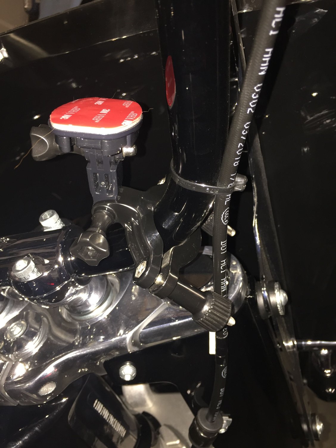

For some reason this picture did not upload right.
