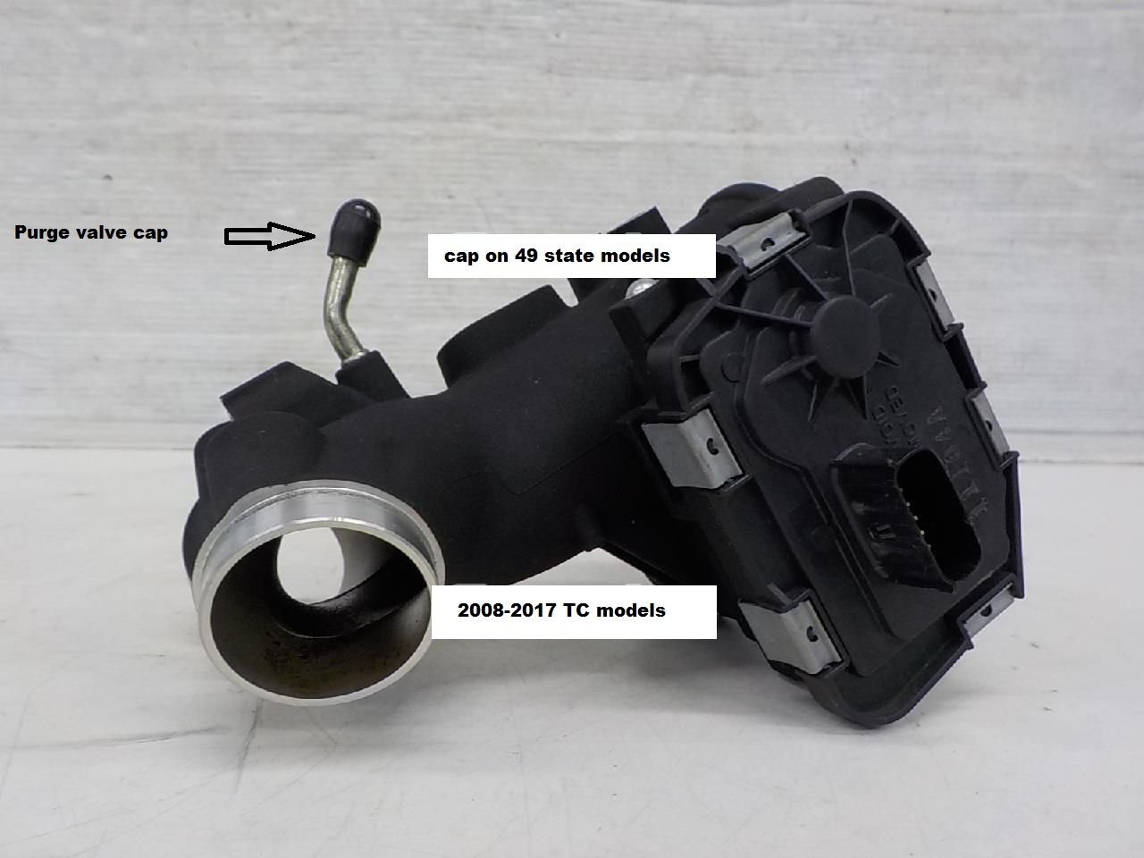

This sometimes happens when the purge valve cap falls off the intake. Check to see if yours is there.
If missing, replace & perform TB reset.
Reset the throttle by setting the run/stop switch to run, then cycling the ignition switch on for 10 seconds, then off for 10 seconds, three times, with no pressure on the throttle grip.
