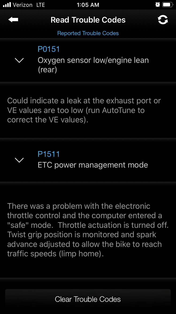

Update: I checked for codes and had 3. Rear cylinder leak/running to lean, Limp mode and ETC error. I checked those three items and electrical connections and throttle plate and then cleared the codes and so far are staying away. The cross over tube to the left slip-on was not tight when I installed the news ones. I used a dremel to open the expansion cuts in the pipe so it could be tightened. I’d say that’s where the exhaust leak/running lean code came from and the other two were a result from it. I made it real mad when I used the top engine cleaner/ lube on it. It forced shut down and threw 3-4 more codes. But they cleared. It still seems to be running the same.

I took it for a 15 minute ride after I cleared the codes. I checked for codes once during and once after that ride and they didn’t come back. Im hoping I hear from them also. Attached is a pic of two of the codes with the FP3 explanations. As I mentioned the exhaust pipe that crosses under the swing arm wasn’t tight at all when I installed the slip ons. To the point that I didn’t have to loosen the clamp to take whole left pipe off of the bike. I was thinking maybe that could have caused that code but then again it’s hard to tell what or if there were codes before I flashed the new map. If I reset the ECM, it would put everything back to stock and I would just flash it again? I’m not sure what to think of it. There are no bad or strange sounds coming from the engine. Only a “rattle” when it acts like it wants to stall when letting out in first. It almost acts like your trying to start out in a higher gear. And that has gotten way better since the twin slash rounds flash.

Good morning Sydney , was thinking about that last night , and it is totally possible the loos crossover could have set that code ( P0151 ) . Glad to hear you were able to take it out for a test run and the codes didn't come back , this is good news .
