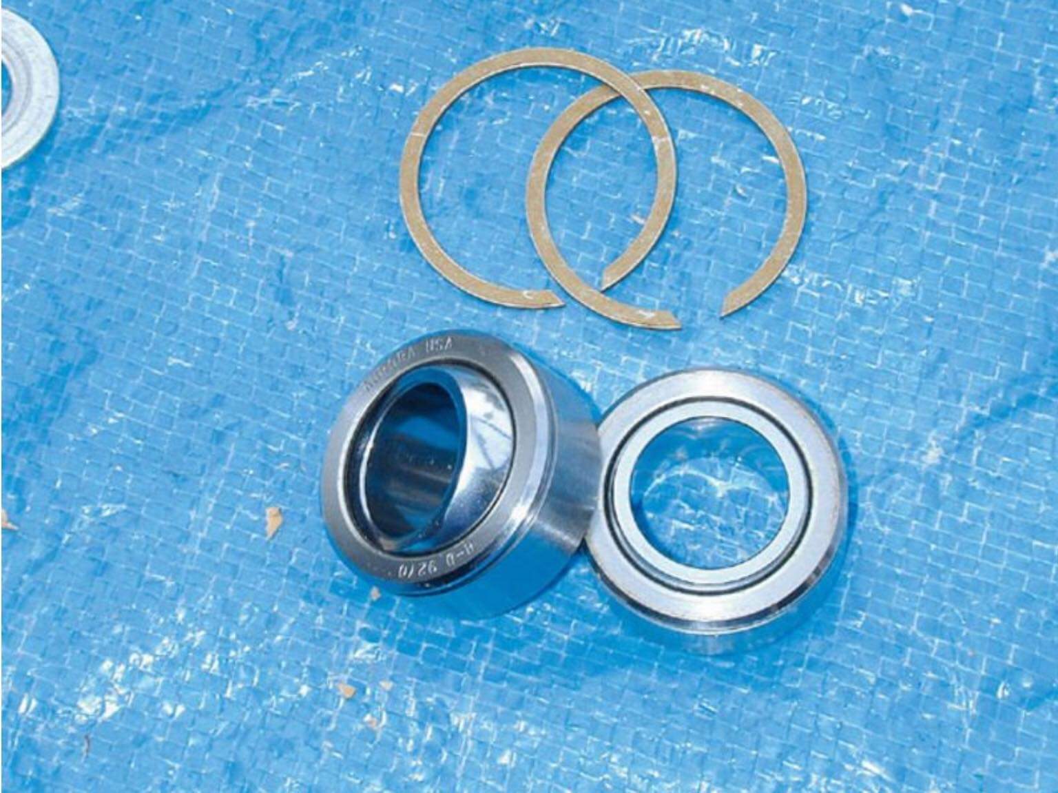

Originally Posted by PeelyP62
Hi all.
can't find a size or part number reference for a 2008 heritage softail classic swinging arm bearing .
all that's marked on the housing is Harly Davidson
any help please.
this type.

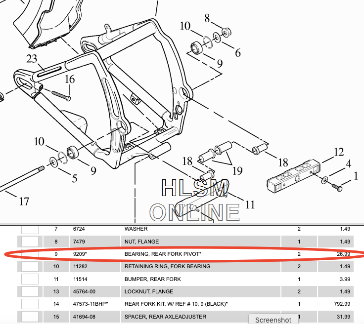

The current p/n is 9209 if you wish to order from dealer
yours show a similar # ( can`t read it) and the manufacturer is AURORA
Assume you have a local bearing supplier who can match it up
