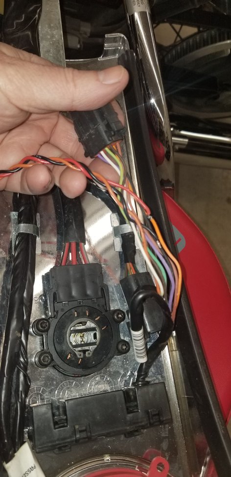

The three input connections are tapped from the indicator light cluster in the console on the tank.
  • +12V ACCY is tapped from the orange wire.
  • GND is the black wire.
  • Hi Beam is the white wire.
Here is a pic of these 3 connections to the indicator light cluster harness under the tank console, which are soldered then insulated:

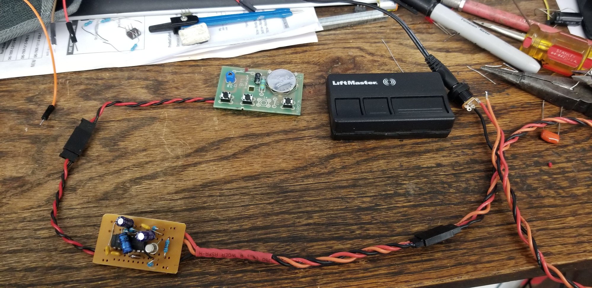

Here's a pic of the hand wired circuit board. I've made a couple changes since the pic was taken, but it's still mostly the same.
After the pic was taken, I protected the board with a sleeve of heat shrink tubing.
It gets installed under the seat/ RH side cover area.
Also shown is the LiftMaster board temporarily out of its housing. I connected the red and black wires to the 'door-open' pushbutton switch.
Since this photo was taken, I made the improvement of putting the opto-isolator (Q2 in the diagram above) right on the LiftMaster board.

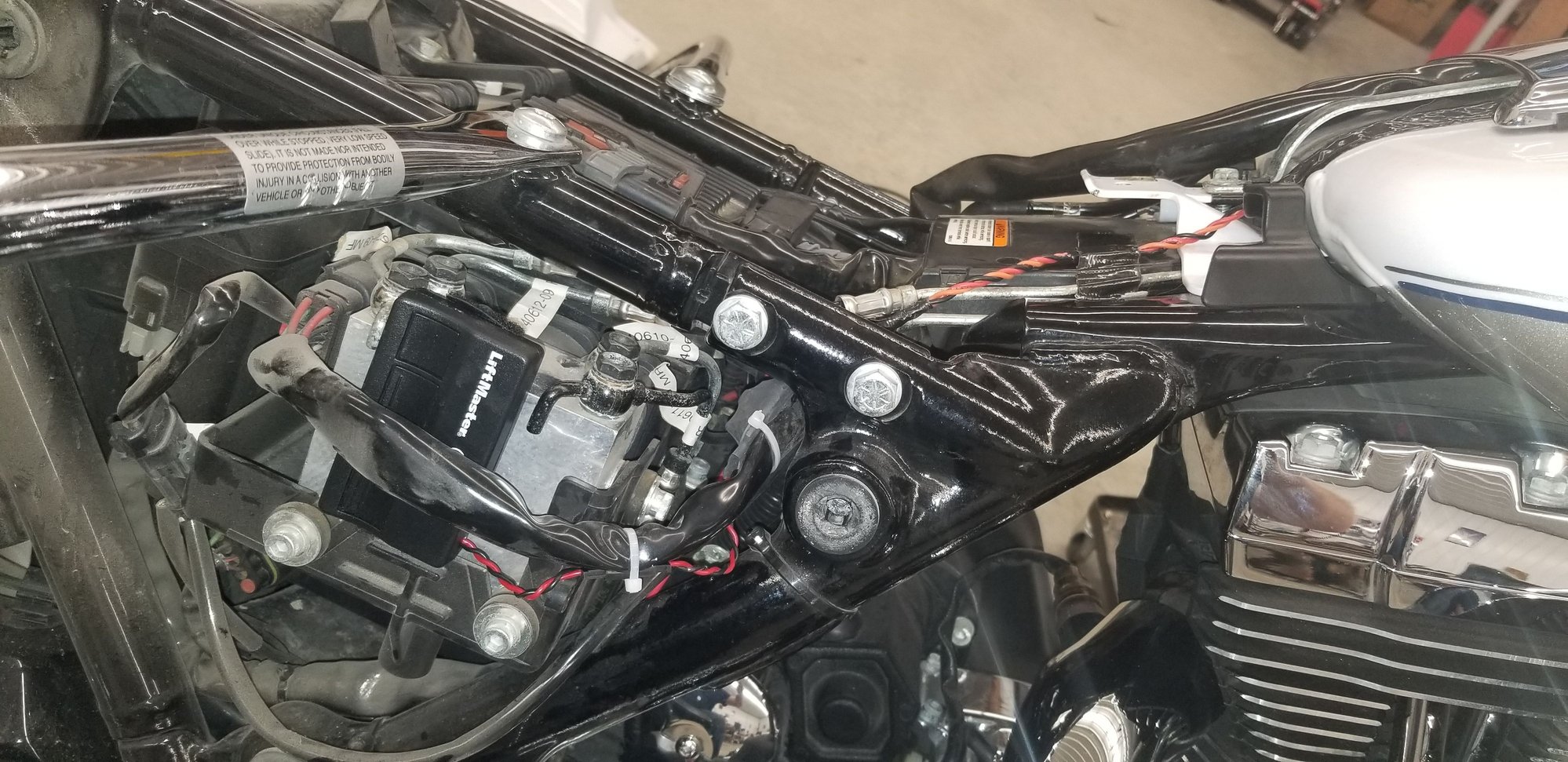

And here it's all installed. Shrink wrapped board is strapped to an existing harness, and the LiftMaster remote is velcro'd to the side of the ABS hydraulic module.
I put it there so that the RF signal from the remote would easily transmit thru the plastic side cover, rather than going thru something metal like the headlight housing.
All wiring is zip-tied or taped in place so that vibration can't cause wiring to rub thru on its insulation.
