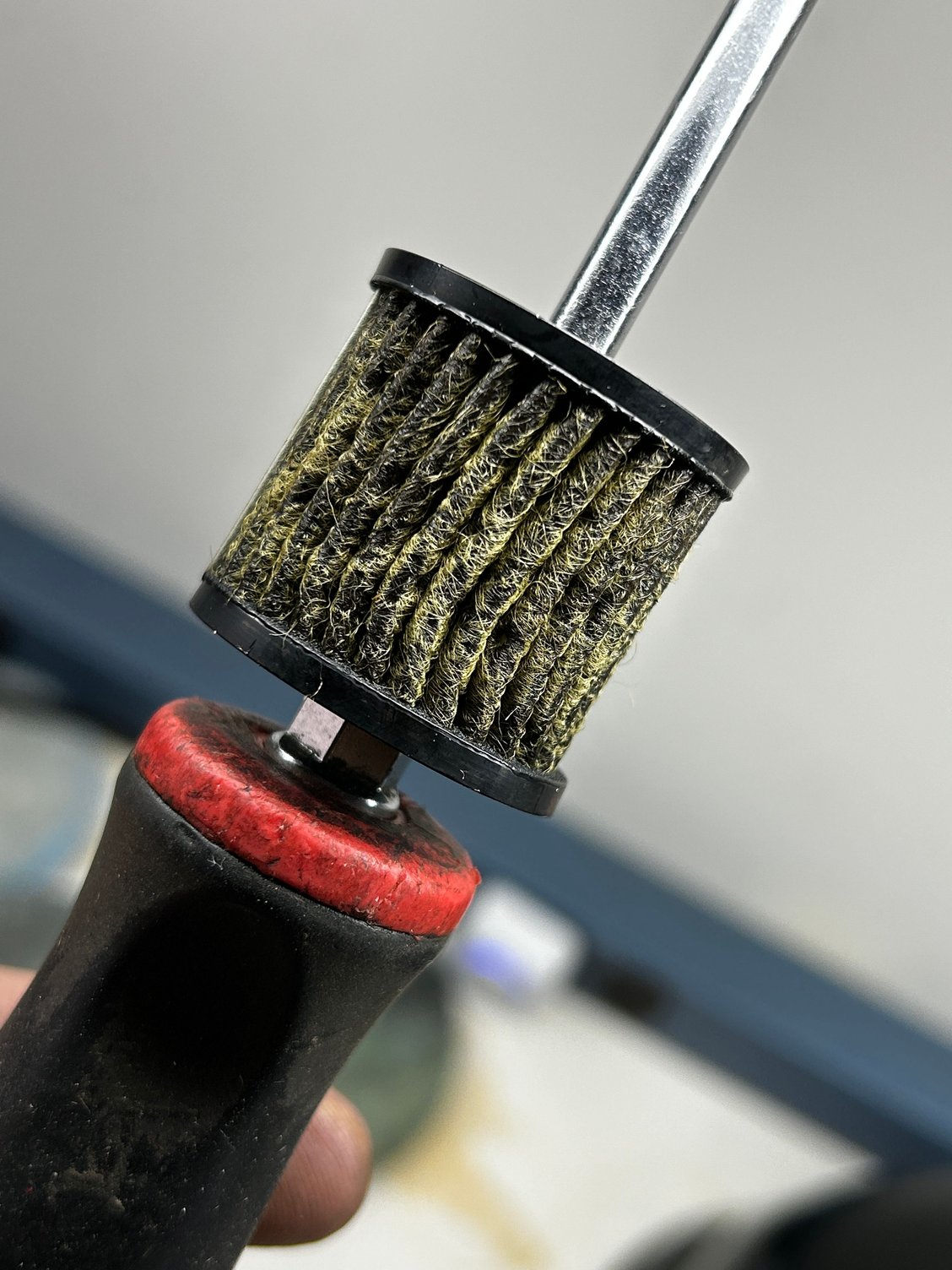

This one only has 60K Miles

That's how mine looked when I changed it last year. Intervals of 100K are laughable. I cut mine open and it was full of fine silt. The filter had about 37K on it.
This would make me suspect of where I was buying my gas from, I think........ That is, if you basically get it from the same place the majority of the time.

They sure do get gnarly looking. I changed mine at 10K, and looked just like those.
