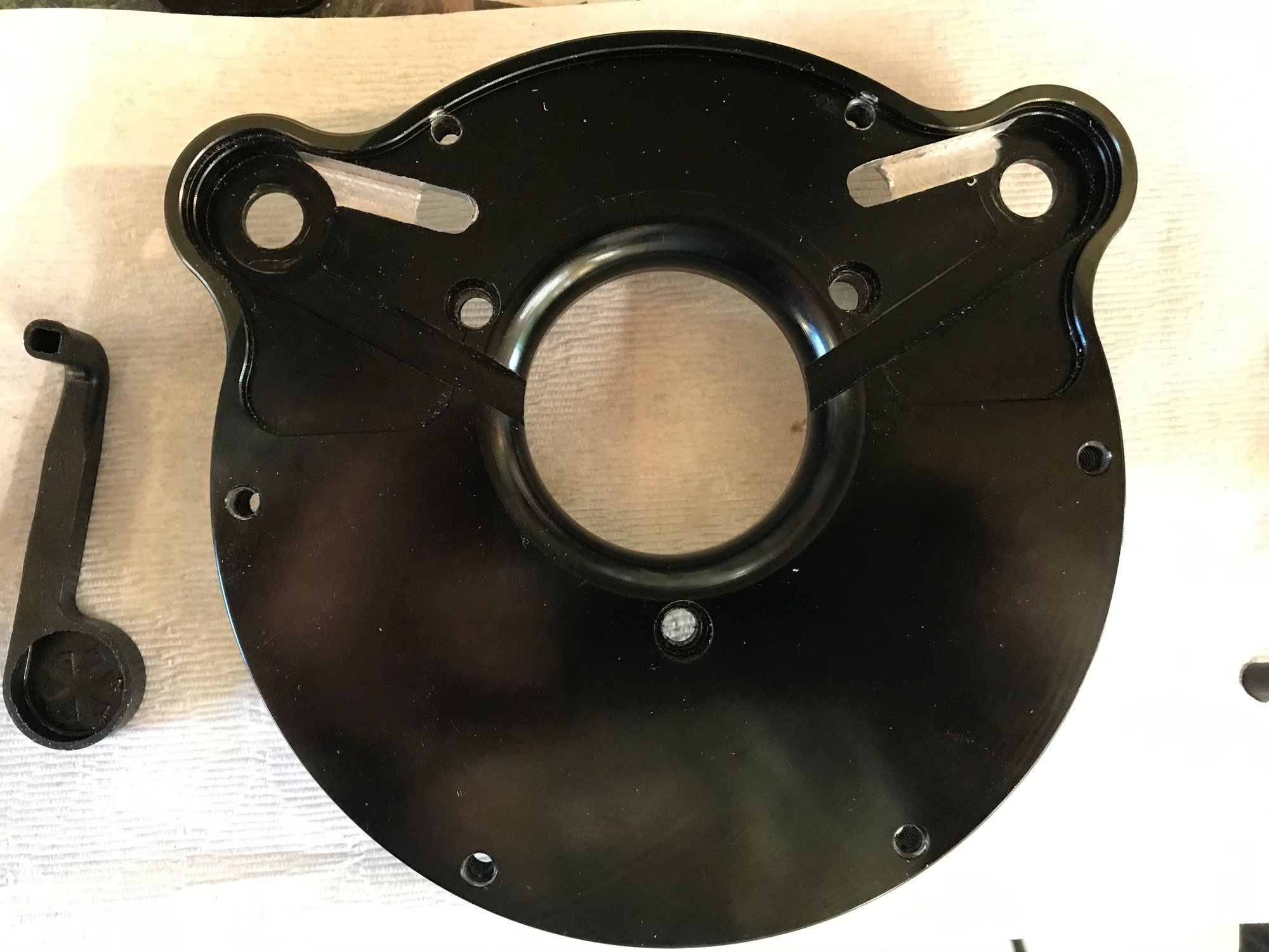

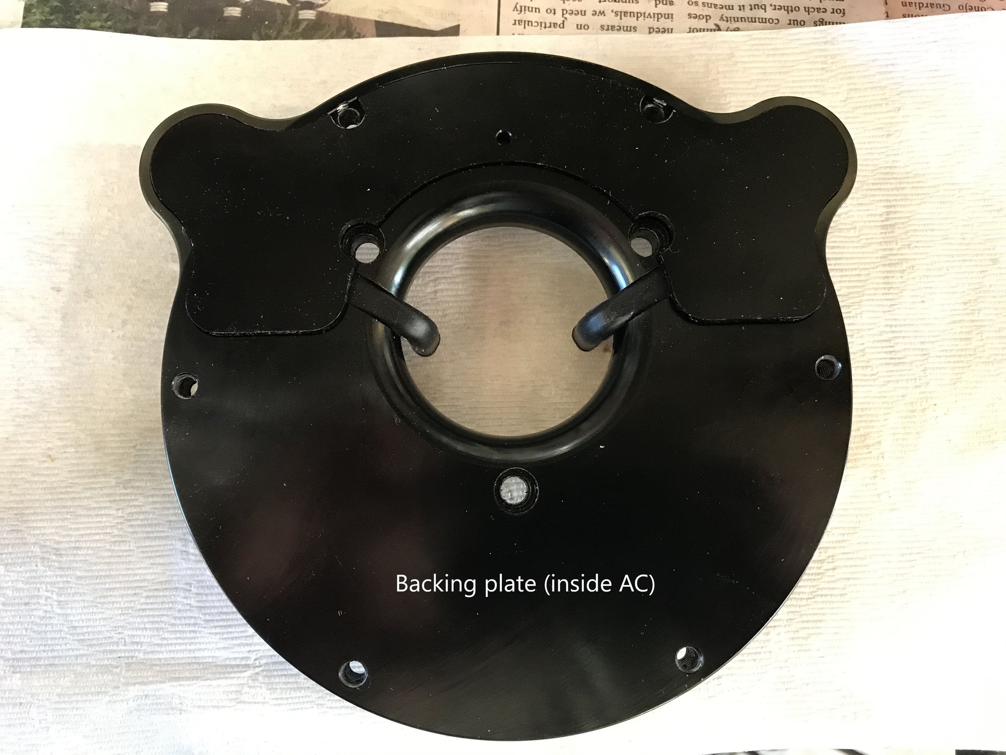

This ended up working well for me, so I thought I would share.
I wanted to externally vent my crankcase, instead of on the inside of this Performance Machine air filter.

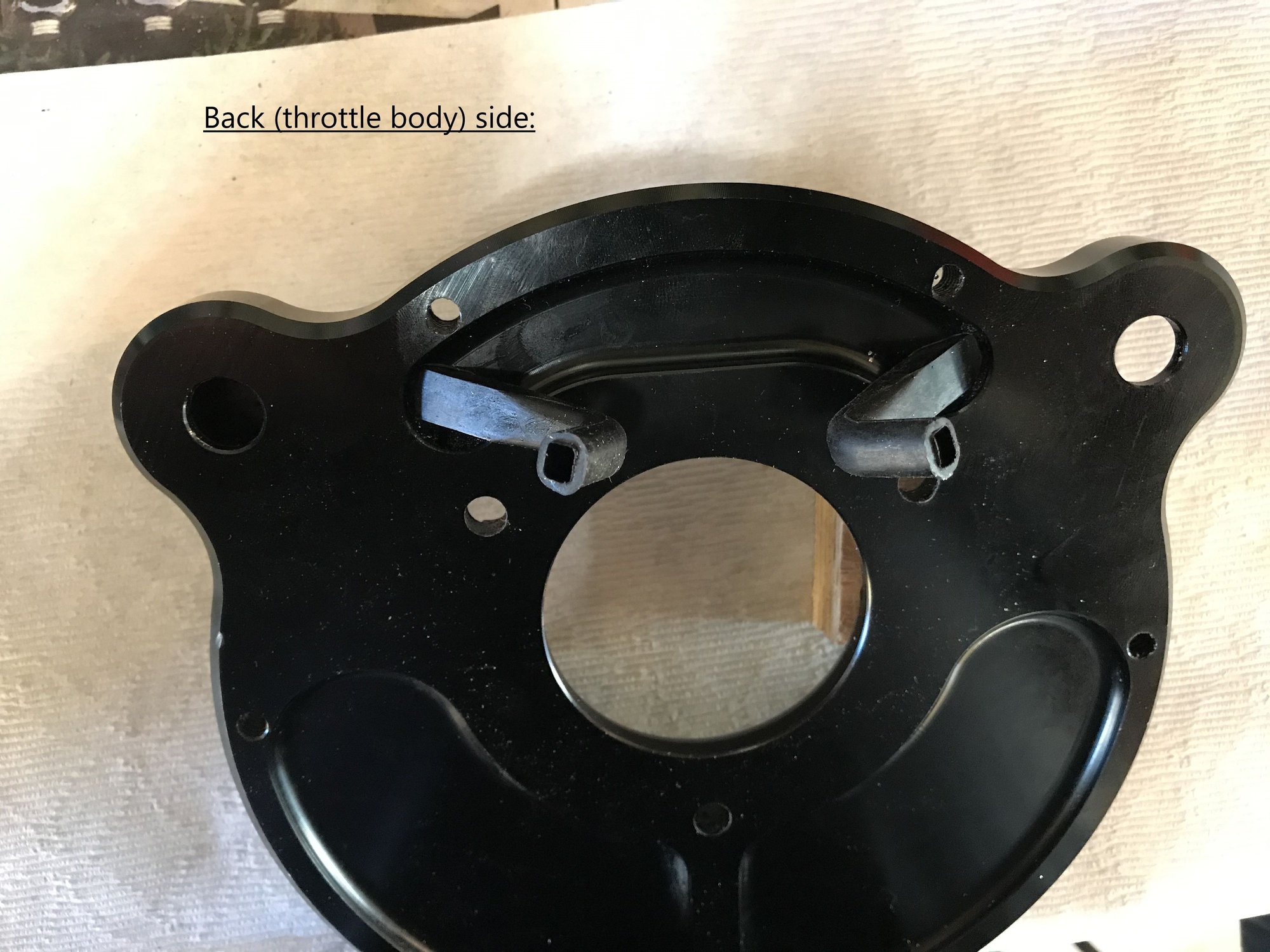

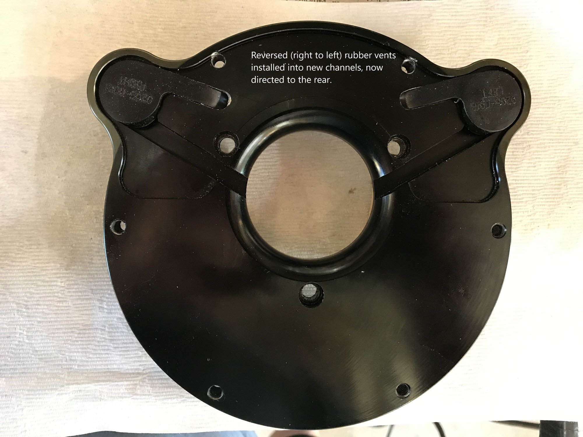

I ended up using my drill press and slide vise to machine a couple new channels in the backing plate.
I then reversed the two rubber ducks (the crankcase vent ducts) right to left, and installed them sticking out the rear of the backing plate.

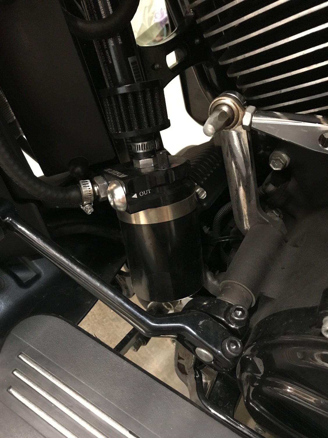

I made a bracket for support and connected these to hose running to an external catch can with vent.

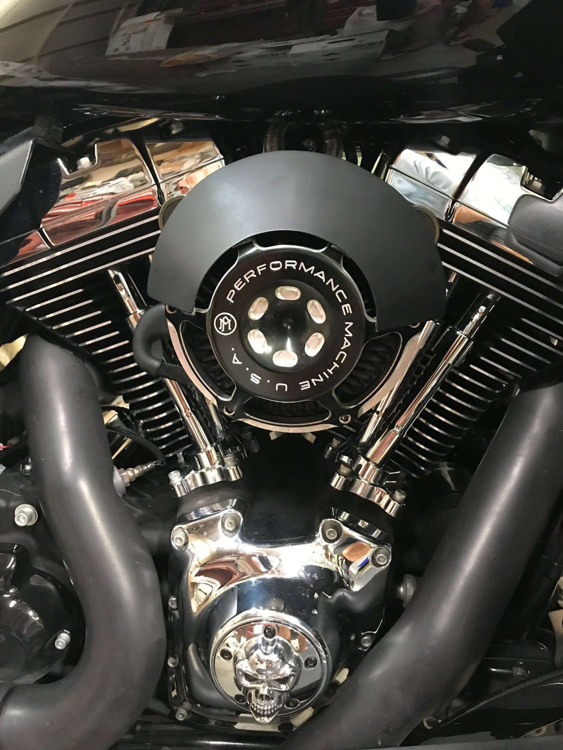

I also made a temporary 'rain cover' for the AC, which shows in the pics. Just did a 4k road trip and all worked perfectly!

I like the way you modded the backing plate to get the hoses out. I suspect that your trap may be too small tho. I find after many miles, the filter on top collects the oil and it blows back on the bike. It's better to simply run a hose down and away from the rear tire.
Old Sep 5, 2020 | 01:37 AM
GearheadMike's Avatar
GearheadMike
Joined: Jan 2020
Posts: 934
Likes: 1,050
From: So Calif
So far, so good. It is about half full after 4k miles, and no oil in the filter part. So it will just get emptied every oil change.
