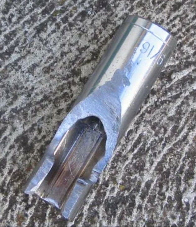

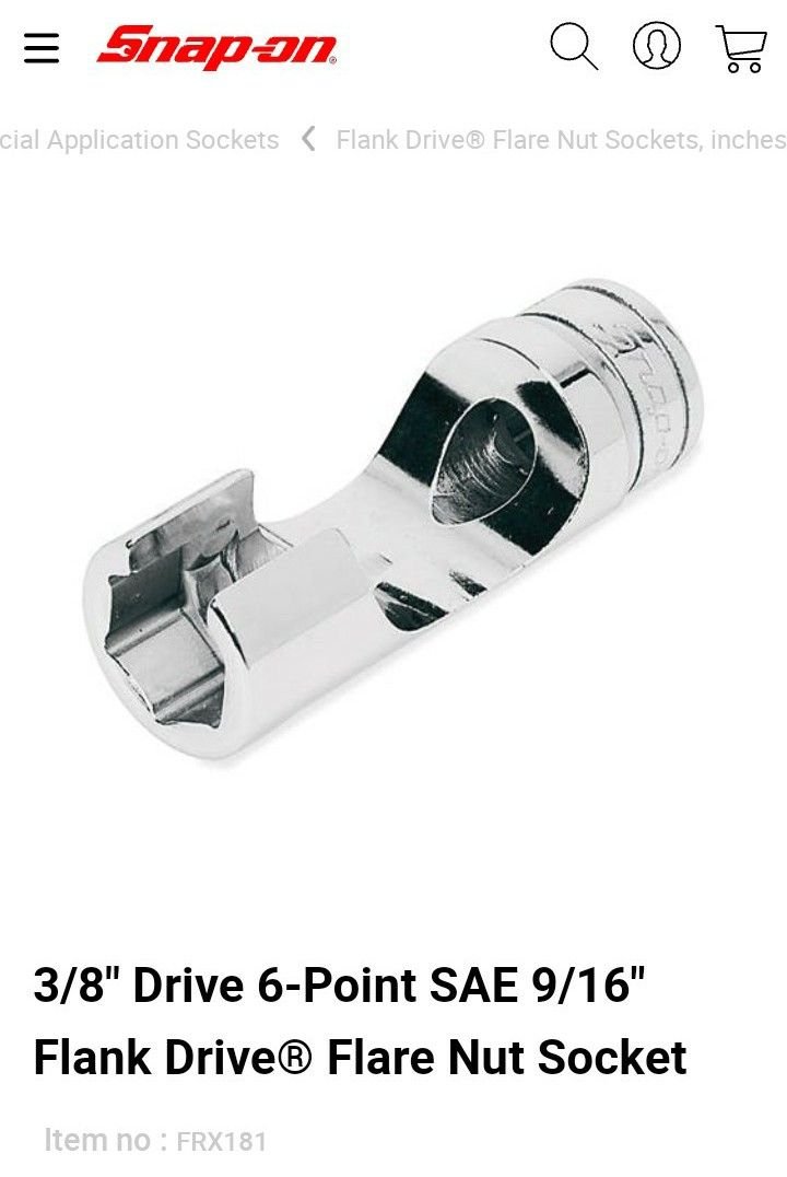

It’s detailed in the service manual. There’s a socket that you can make or buy to loosen the nut.

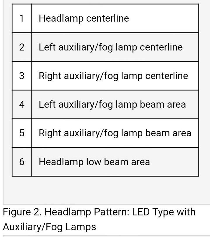

The correct positioning of the AUX driving lights is clutch side straight and slightly down, throttle side slightly down and slightly right (curbside).
At least here where we drive on the right side of the road.
They're there to fill in the dark spots.

This^^^ 9/16" flare nut socket, buy or make. You'll need to remove the turn signals to access the nut.

That is correct for halogen, but not the OP's LEDs.
