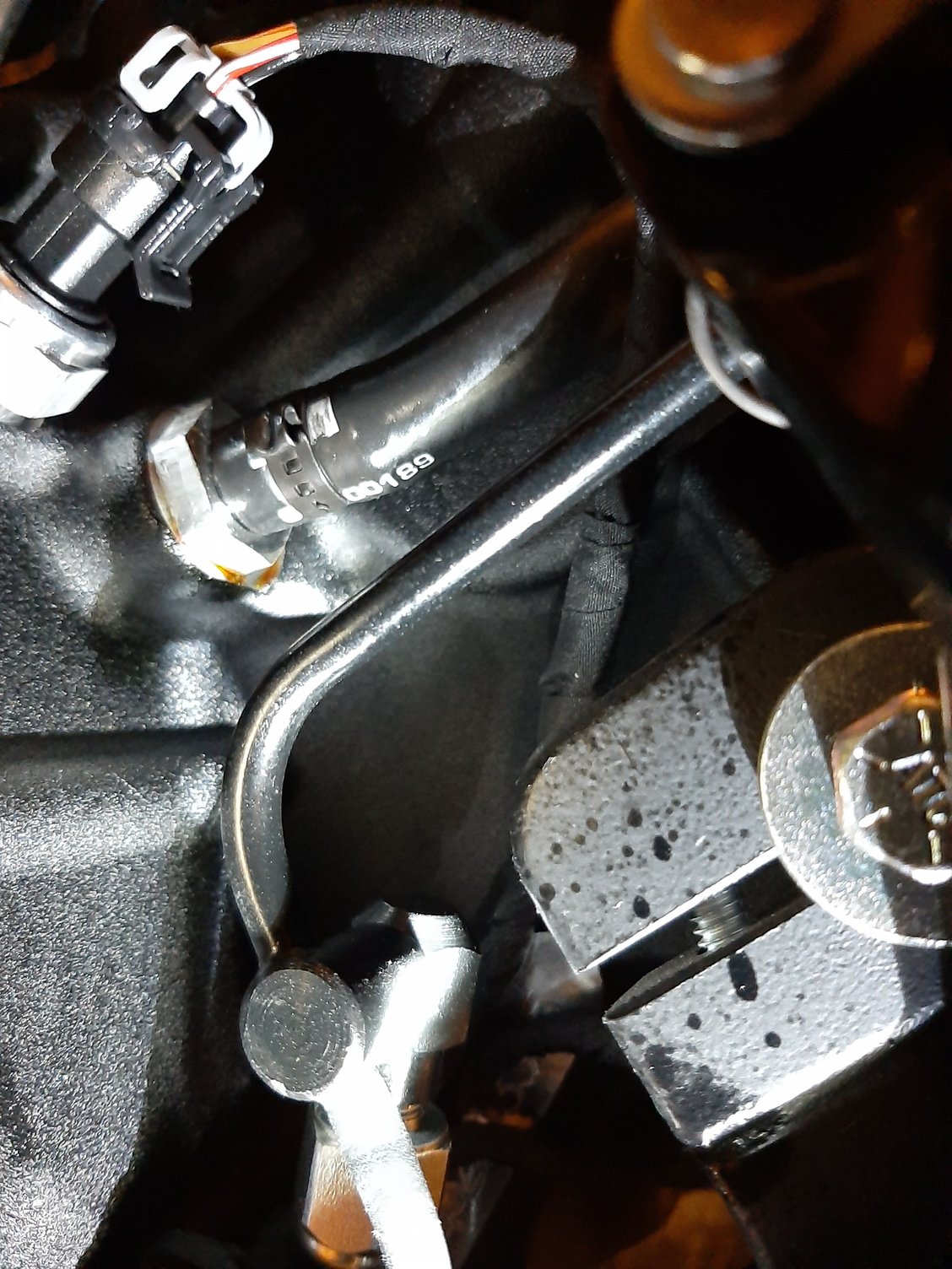

Does this look like an oil leak, or assembly lube coming out? It's where the oil goes out to the cooler on a new softail.

How new? If you have warranty run it by the dealer and let them have a look.
Definitely looks to be coming from under the hose connection. Flawed oring or loose fitting?

It's brand new. Only 5 miles on the odometer - the first test ride the tech did before delivering it (it's winter here). Dealer looked at picture and said it's assembly lube, but, does assembly lube look and feel just like motor oil?

Sure it could be and looks like SE type assembly lube. Although not sure why it’s required there. Clean it off and keep an eye on it. You’ll know before long.

Sure looks like oil to me! The bolt with the threads showing on the right side of the picture looks cross threaded.

I would take a wrench to it and try and snug it up and then clean it off and keep an eye on it. Don't mention you did anything to it if it has to go to the dealer.

Spray a little brake clean around that and keep an eye on it. I would not advise to clean it off, start it and let it run a few times. I would clean the area and let it sit. When the weather is agreeable, check to make sure it's still dry, go for a short 5-10 mile ride and check when you get back home. If still leaking, go back to dealer.

Thx for the responses. I don't have the proper wrench to tighten it, but does anyone know the proper torque setting for that particular bolt?

It doesn’t require clamping torque as it’s just a fitting. I’d guess drain plug torque should be fine 14-21 ft.lbs
but clean it off first and see if it even still leaks.
