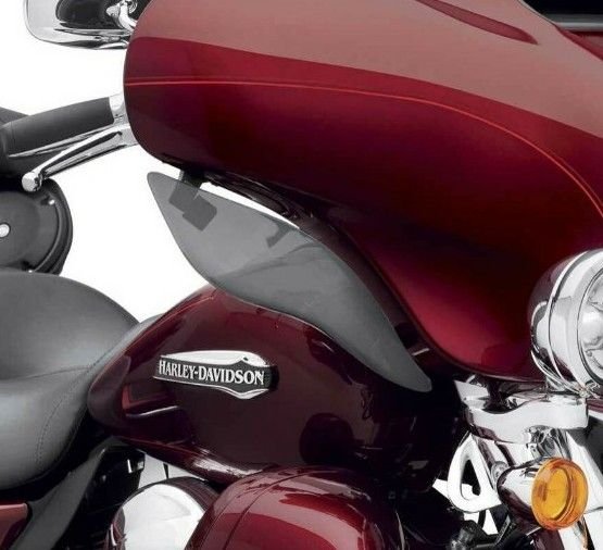

If you're talking about these HD adjustable air deflectors,
you'll need six of these.

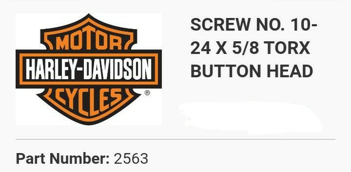

Andrew, Hi from just down the A1 and welcome to HDF. Be aware that those screws will be US thread size, not metric or old British. They are not widely available here, but can be found at specialist suppliers, including your local Harley dealer.

A possibility is stainless - 10-24", UNC SOCKET BUTTON HEAD BOLTS A2 STAINLESS STEEL SCREWS, HARLEY IMPERIAL | eBay
