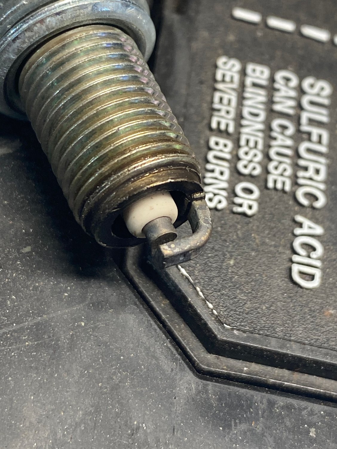

I pulled my plugs and the round part is completely white, and the electrode is a mix of gray and black.

Probably valve train noise. Normal. Post pics of your plugs, but reading plugs with EFI is not like with carbed bikes.

It sounds like it's running lean. I solved that problem with a Power Commander from Fuel Moto but I see you already have a tuner. Maybe you should richen it up.

Thank you for the suggestions do far. Here are my spark plugs. Brand new by the way. Got them from the dealer maybe 2 weeks ago? 6R12, properly gapped by myself, according to service manual.
first one is front cylinder.

Plugs look fine to me
