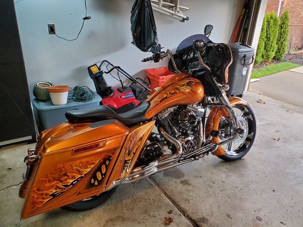

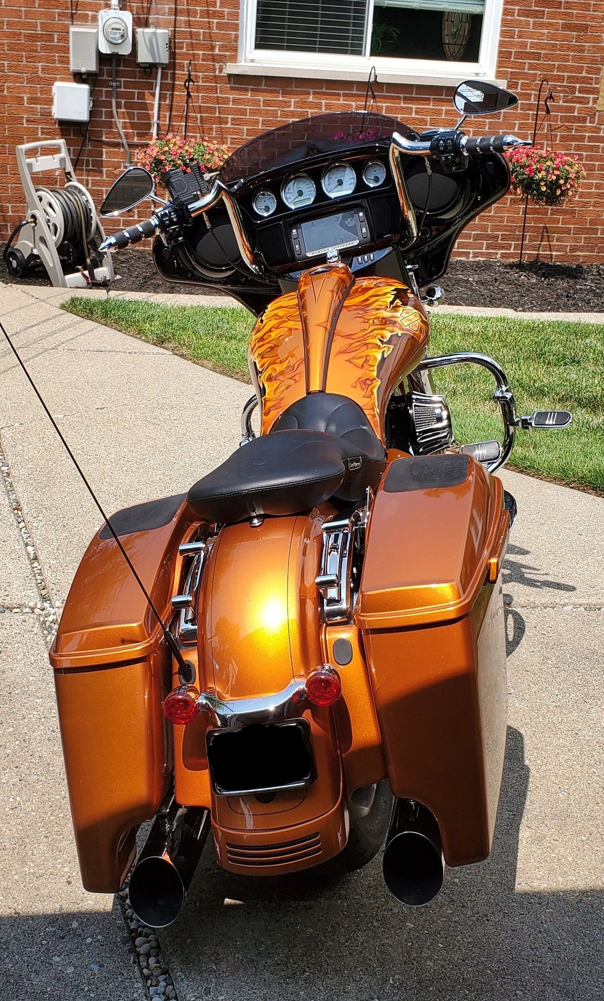

A friend and I put some KST Mayhem Bagger bars on my 2014 SGS last spring and I have a single suggestion for those who are changing bars...... get on the bike and start it up, drive to your preferred HD shop or wherever you go for any type of work you have done.... turn the bike off and go inside and hand them the keys and tell them what you are looking to get done. Have your ride pick you up and go to your favorite watering hole and have an adult beverage and thank yourself for a job well done. Some jobs are just worth paying for imho.
