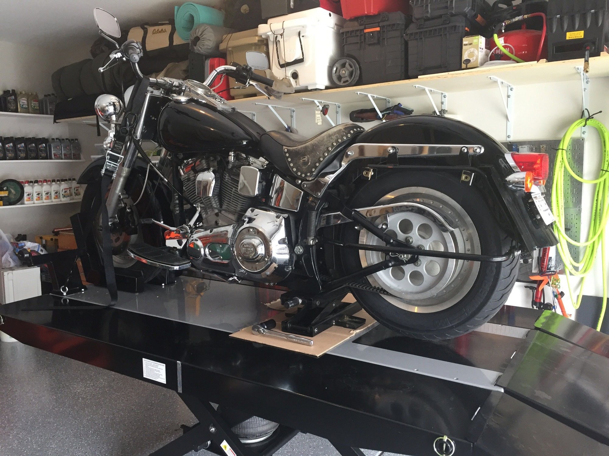

That is not a lift, it is a scissor jack.
It is used to raise one end of the motorcycle at a time.
Example:

Scissor lift, scissor jack, anyone can call it what ever they want...
It is a simple scissor jack, they call it a lift to be deceiving.
This is from the description in the link you posted:
NEW 1,100lb Motorcycle Center Jack Scissor Lift Stand Hoist. This scissor lift can raise the bike from the front or the rear and will support up to 1000 pounds.
It is a very useful tool, but I don`t think it is what you are looking for.
The best use for this type of jack is not on the garage floor, but on a table lift, where the bike is secured by a front wheel chock and tiedown straps, or a rear wheel chock and tiedown straps.
