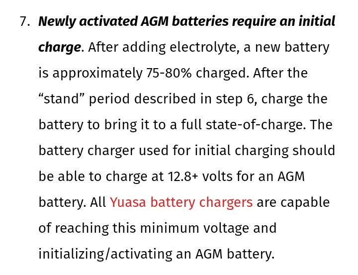

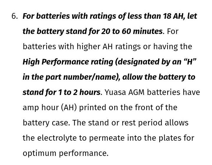

This is what Yuasa has to say about their batteries. After adding electrolyte, there is a "stand" period, after which a charge is required.
