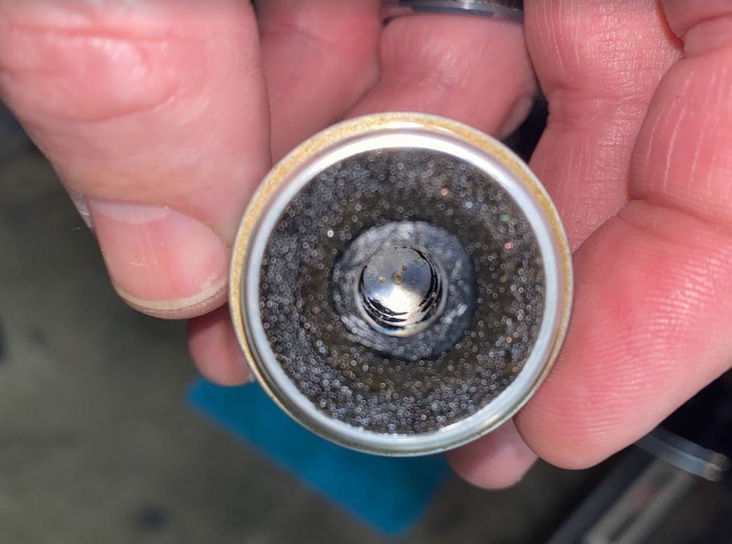

Got the stuff from DK customs, pricey but I wanted a clean look.

Same here and I wanted to see what it was catching. Checked after running a tank of gas it appeared to be mostly water. About a tablespoon.

Mine came out almost empty after about 1,000 miles.
BTW, I modified the foam in mine by punching a hole down the middle, and then adding a 'side-vented' tube all the way to the bottom of the can.
This forces the air/oil mixture to dissipate through the foam, instead of just bouncing right off of the top of it and gurgling out the vent holes.
