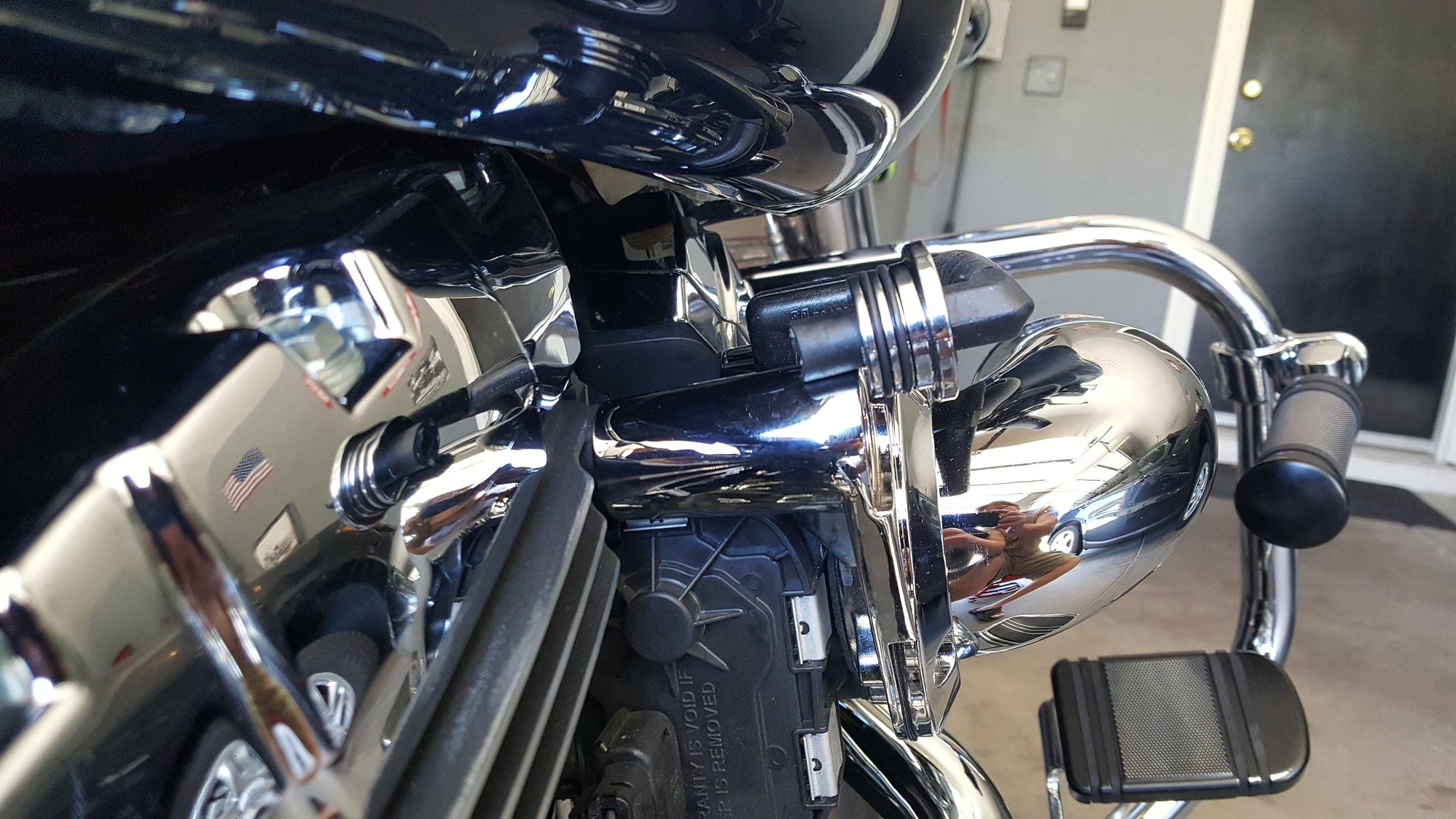

Just finished my breather bypass on the SE heavy breather. What do you think?
Hose going down to the front.
1/4 tube connected to the breather bolts.

Looks great, what parts did you use? Looks like Rushmore fittings, but which bolts?

I used 1/8 npt x 1/4 barb fittings 2 each. Drilled and tapped the breather plugs and used a 1/4 tee to tie it all together. Painted the fittings with black plasti dip.
