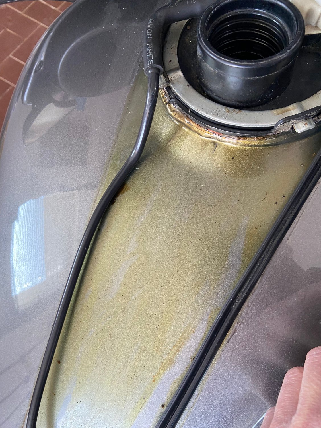

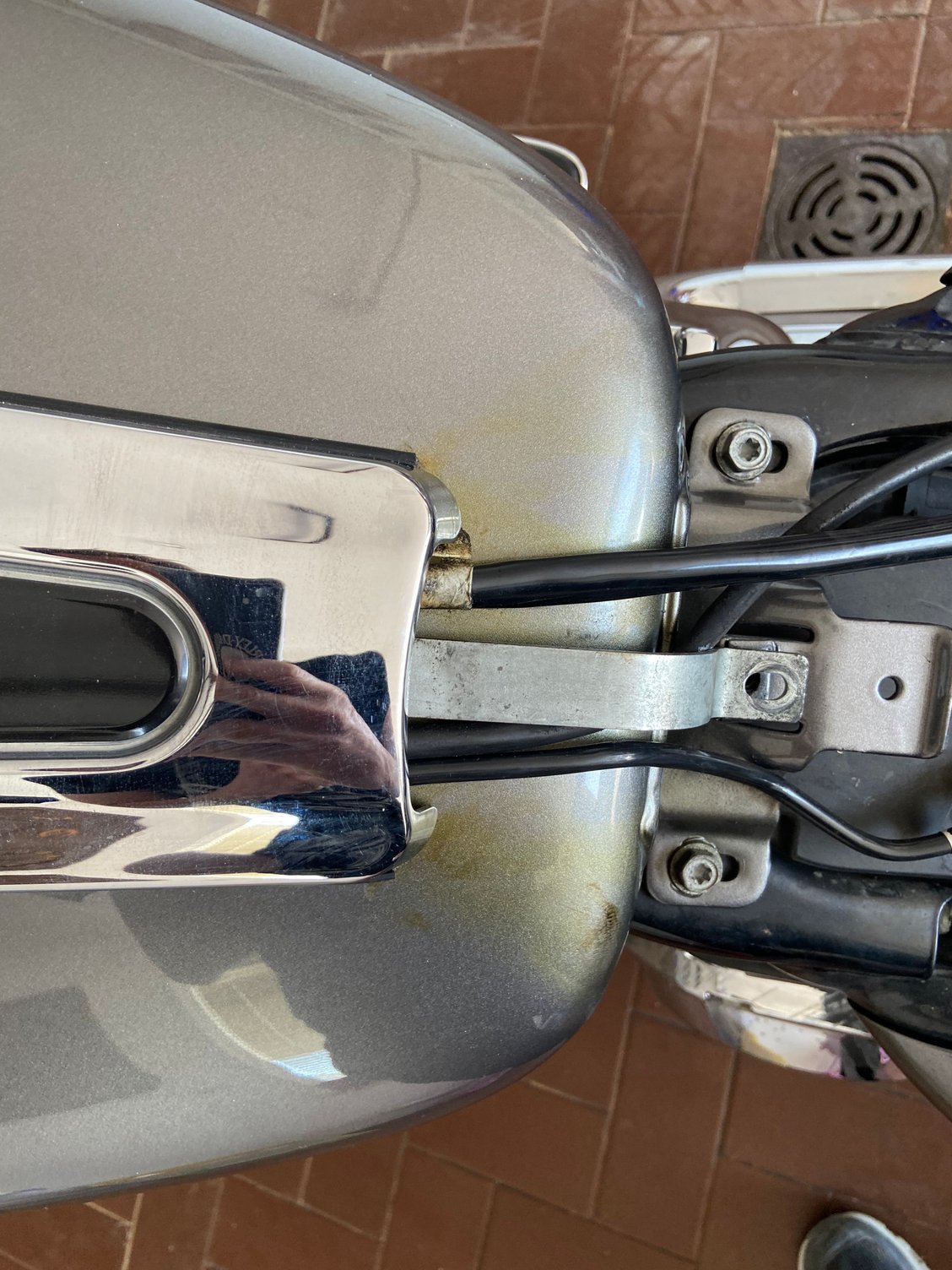

Dear all,
i have 2014 SG. After a time I have noticed, that there is “stain” under the centre console of my street glide (picures below).
I will be very happy if someone have solution for this problem, or have similar problem?

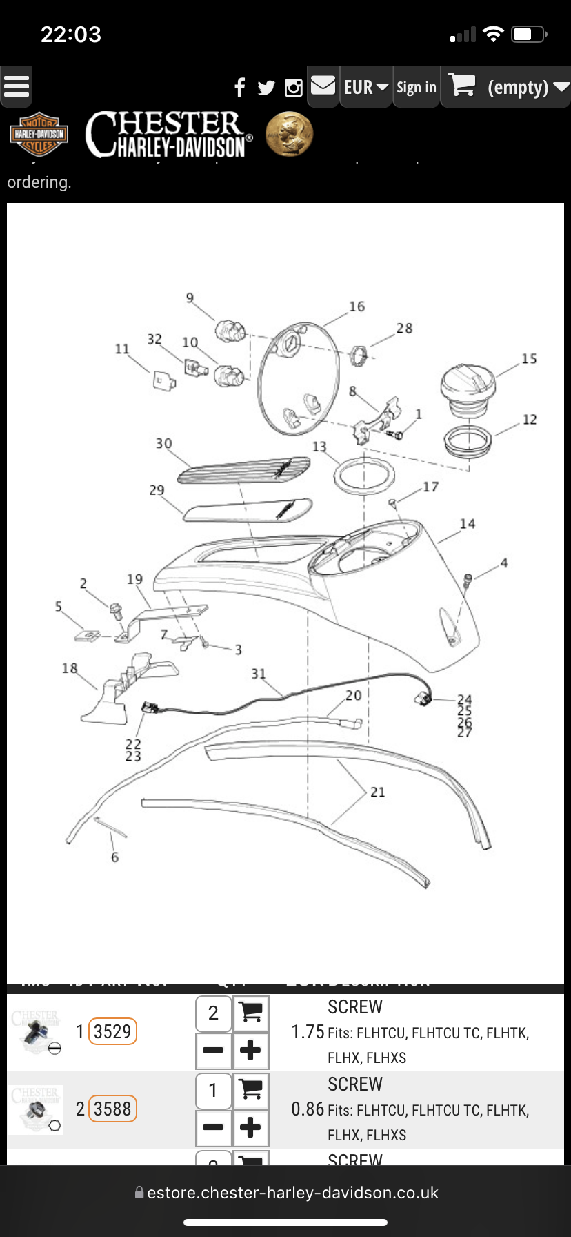

You mean this product, number 12 in attached picture?

Item 12 is cap gasket. And that just may be problem. Look at it and the neck sealing area.
But I was referring to the lower neck gasket. Item 13 maybe. Find the fish showing neck.
It's that black rubber ring on tank under that locking ring in your third picture

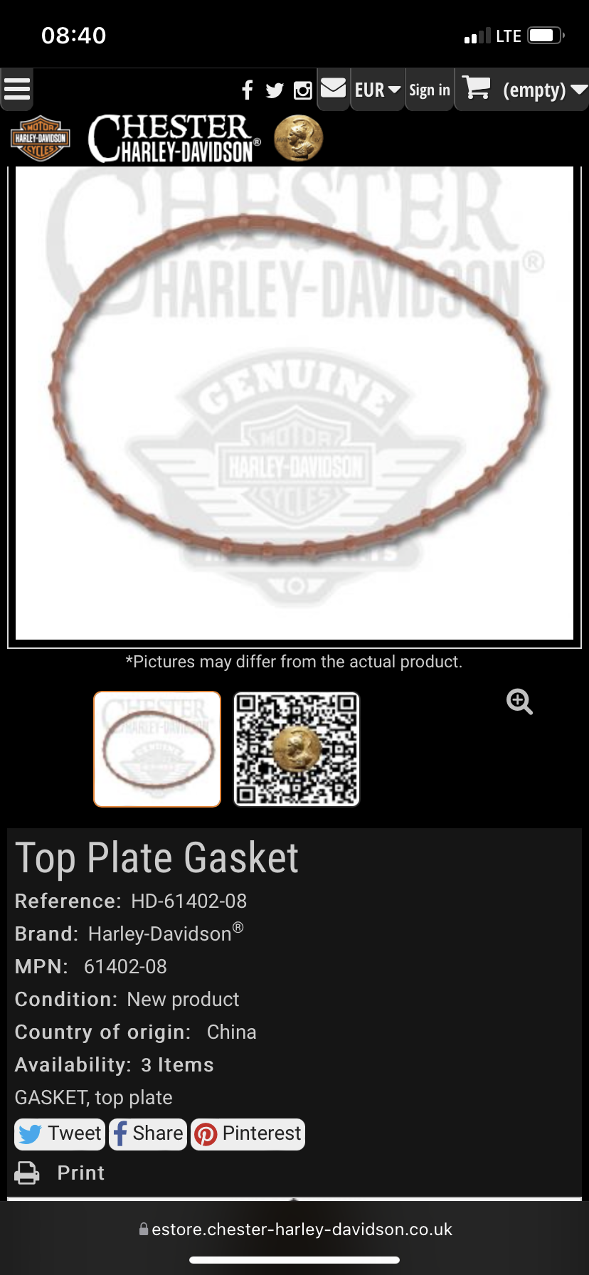

Can anybody find me this part or part number?

2014 street glide. Top plate gasket. 61402-08. $6.00
Key on the path below. Then on left, hit fuel pump assembly
https://partsfinder.onlinemicrofiche...EET%20GLIDE%20
https://partsfinder.onlinemicrofiche...EET%20GLIDE%20[KB]%20FUEL%20TANK%20ASSEMBLY

Can i change this prt on my own, or do I need some special tool?
is this the right product?

You'll need to decide with your model and part listing if that is correct part.
Be sure the tool you use to turn locking ring is of the type of material that does not spark. Like a brass rod or hard wood dowel.
That's what I would use.
I really can't help you on your ability or your selection for proper tool you have or use.
Be careful. Work outside and be sure tank is empty and protected from anything falling inside it. Fumes inside it if ignited can flash up and cause serious injuries.

Are you seeing wet fuel there? From what I see in the pictures looks to be stains from spilled fuel.
Thats what I was thinking. Sometimes people over think somethings. Maybe clean it up and run it a week or so.
