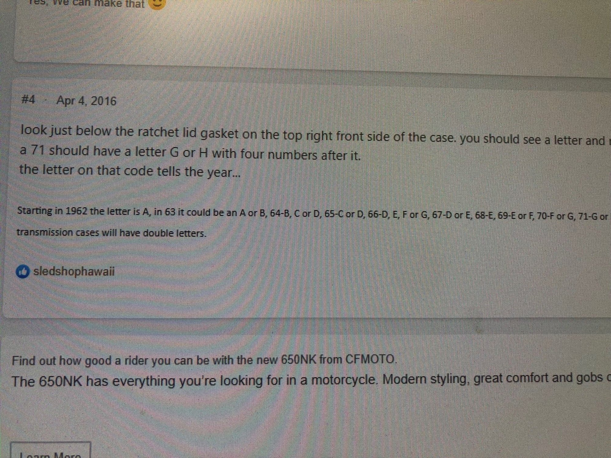

I got a question the Id numbers on trans is A 1997 what year number is it so I can rebuild it kick start only 3 speed

Send a pic of this transmission please
What did you remove it from ?
Last year for 3 spd w/o reverse is 1952
Last year for 3 with reverse / kick only is `63

I can't get a good pic but the numbers are A 1997

trans in pic is a 4 spd

ok so is it a 1963 since the Id number start with a A
See below

See below
Thanks it's either a 62 or 63
