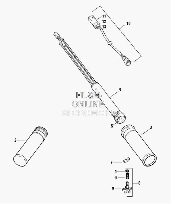

The throttle on my 2008 Road King CVO is sticking wherever I let go of it (just above idle, half throttle, or full throttle).. It does it running or not that's why I think it might be in the handle bar grip. Bike does have throttle by wire though. Is there a return spring in the handle bar grip?.

Doesn't appear to be. Maybe your throttle lock is dragging? No 8 in picture. Back it all the way out. May be just dirt in there too. Otherwise I'd be looking at the throttle body and controls.

I don't have a no 8. Would the throttle body itself stick even with the ignition off?

Short answer is not likely. Strange, the photo is from Ronnie's Microfiche for an '08 Road King.

My no. 8 is different.

Is it different because it's a CVO? The pic I sent is from an '08 RK.
