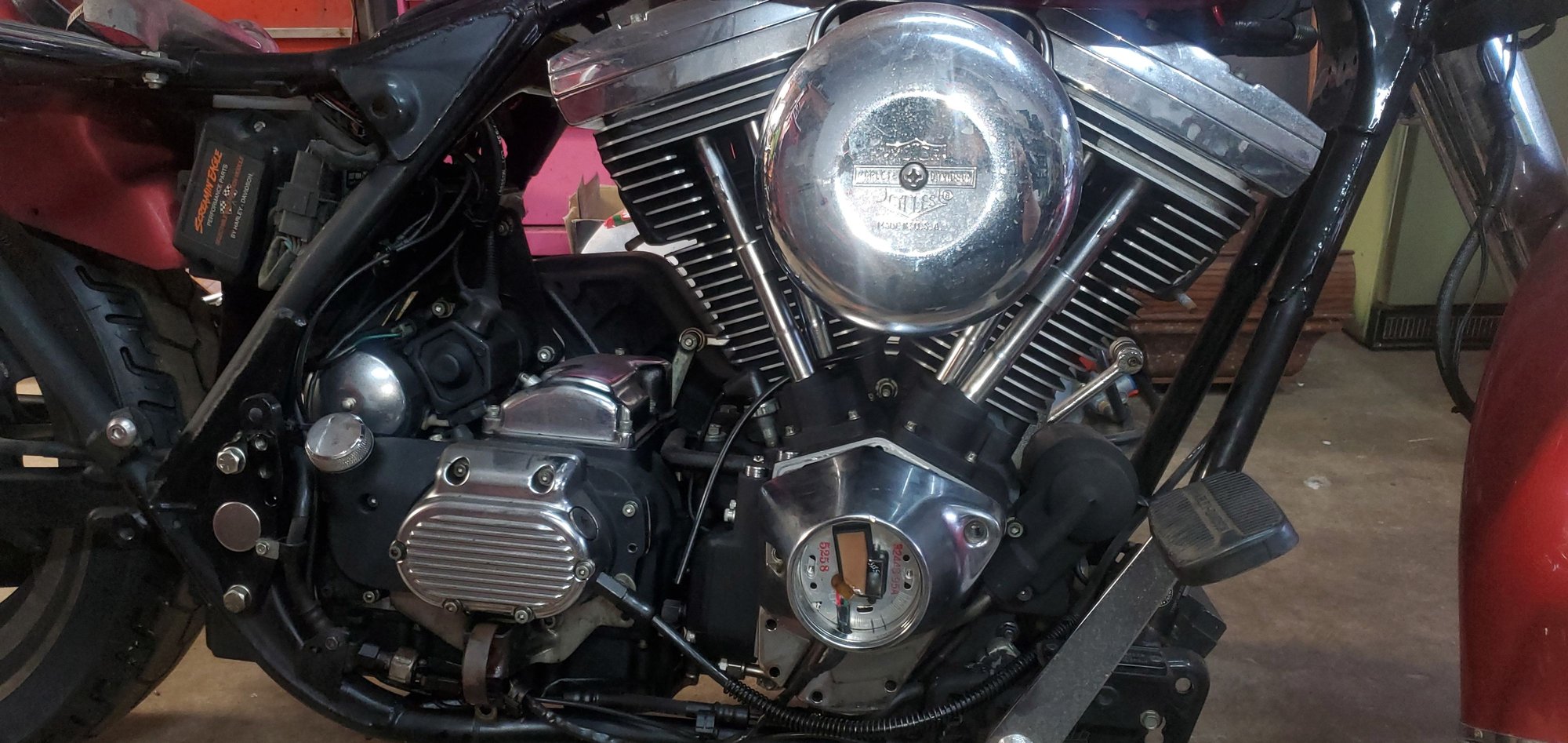

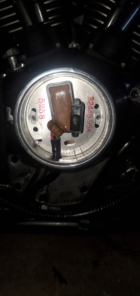

Little update though;
Started pulling it apart to get it ready, and apparently it's been some tears since I've had it apart. Forgot that it has a Screaming Eagle selectable race ignition. Makes me wonder what else is modified on it.
Pulled the cam cover off and the cam didn't even move. Should've done this YEARS ago!
The upper rear portion of the gasket had blown out when the Allen bolts worked loose. Which I think may have been cause by me not torqueing them down when I put the clutch cable on for the 18" gorilla bars on.

Yeah, as Paul said you can pull the cover without removing the pushrods and lifters. Just make sure the cam doesn't move. It will drop a little. You may need to use some small rods in a couple bolt holes to lift up while you put in a couple bolts though. Maybe I'm reading your post wrong, but why did you loosen or remove some of the cam cover bolts to replace the clutch cable?

There's a 3 bolt cable retainer on the bottom of the cam cover that holds the clutch cable against it away from the exhaust. I did the bars and what not like 7 years ago and it lasted about 4 years. Then a slight weep turn into a blown out gasket In a couple days (about 300 miles)
