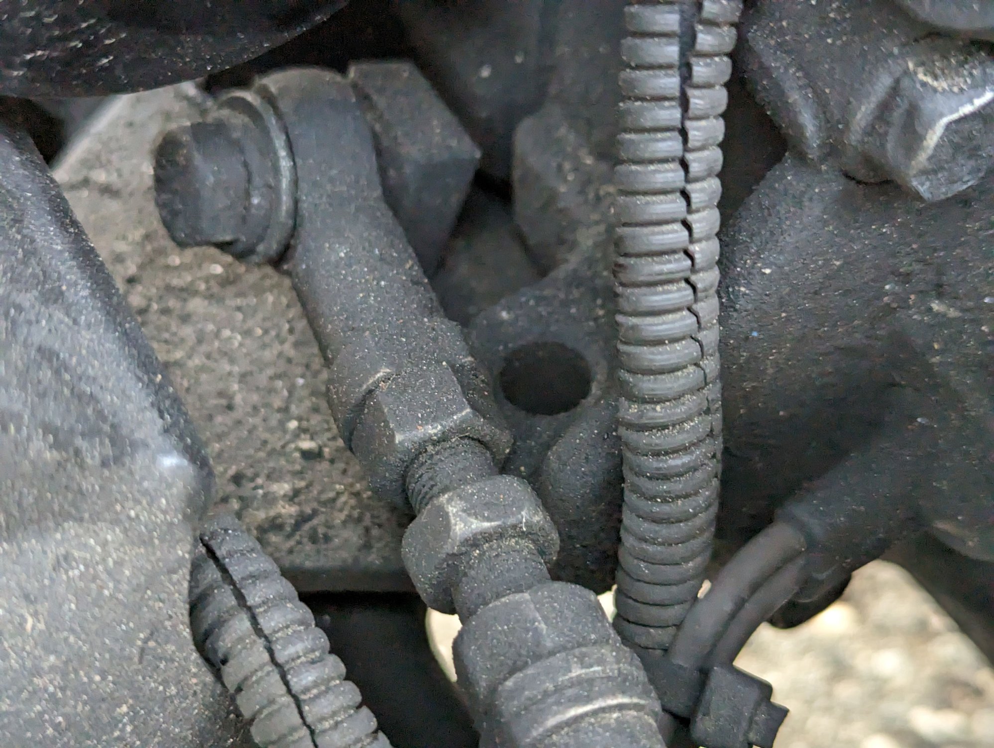

Default Riding with missing motor mount bolts
I've discovered that the bolts the secure my front motor mount plate to the engine are missing. Both of them. The road grime looks uniform so I suspect they've been gone for a while. Unless they rattled out recently, the last mechanic to touch that area of the bike was over 2 years ago.
Should I be concerned about any damage? Anything I should look for? What kind of damage could I have done to my bike while riding with missing motor mount bolts. Everything seems okay while riding, except for a little extra rattle and clunk when I hit pot holes and bumps.
I'm going to be picking up OEM nuts, bolts, lock washers, and washers as well as replacing the front motor mount ASAP.
Old Mar 9, 2023 | 09:52 PM
tdrglide's Avatar
tdrglide
Joined: Mar 2020
Posts: 659
Likes: 359
From: Sierra foothills
Amazing. I can see maybe the nuts coming loose but....
maybe more to the story
Put some nuts and bolts and washers back in, and ride on
