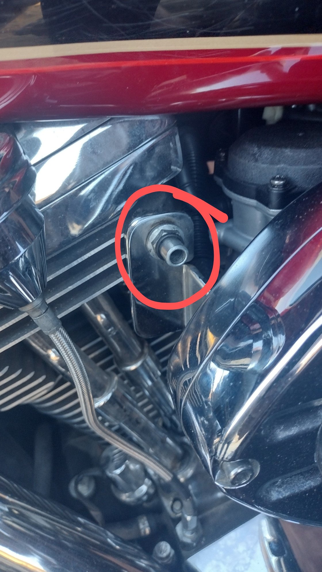

Yep just bought is for 1500 so I can afford to do what I have to to get it running good..
there is a hollow bot on left side of bracket for Carburator..It's open to atmosphere and it is in the cylinder head..
Is that a breather for engine?

A more detailed pic of bolt blowing air out
