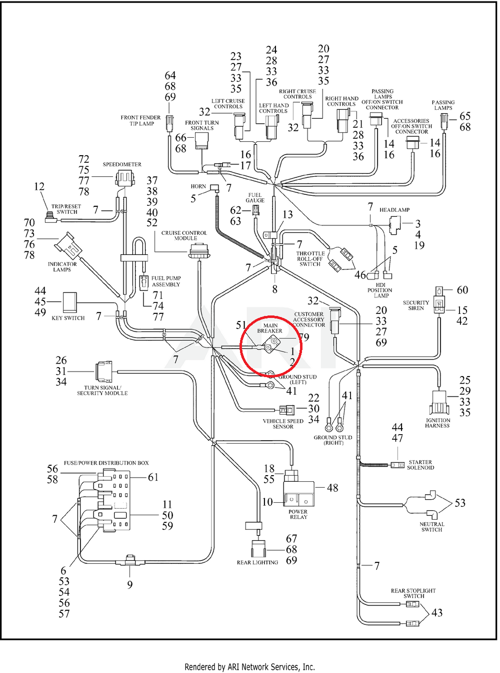

Did you have the recall the service performed on your bike?
I seem to remember something about the 40 amp fuse circuit breaker being replaced with a 50 amp fuse circuit breaker to remedy the issue of the bike shutting down and restarting after the fuse circuit breaker resets.
Plenty of information out on the web about this:
RECALL
DEFECT #1 - ELECTRICAL SYSTEM: FUSES AND CIRCUIT BREAKERS
Description
On certain 2000-2003 touring and police model motorcycles, the 40 amp main circuit breaker can open for reasons other than which it was designed, causing an unexpected interruption of all electrical power to the motorcycle.
Consequence
This condition could cause the motorcycle to stall, which could result in a crash.
Corrective Action
Dealers will replace the circuit breaker. Owner notification began april 23, 2004. Owners should contact harley-davidson at 1-414-343-4056.
Had the same problem with 03 Ultra, dealer recall had replaced the 40 amp with a 50 amp! Happened again with the 50 amp, dealer mech said it was not unusual for the breaker to get weak, $12 replaced myself and bought a spare to keep with me.Ref: 28
74600-94A
FUSE,50AMP
This part replaces 74600-94.
Price:$12.73
Ref:79
74600-94A
FUSE,50AMP
Price: $12.73

Old Aug 13, 2023 | 02:45 PM
Max Headflow's Avatar
Max Headflow
Joined: Dec 2005
Posts: 19,900
Likes: 8,007
From: poway
For once Rounders is close.. Bike does have a circuit breaker, self resetting. IIRC it's 30 amps.. Don't really need to be more but the terminals to the breaker should be clean and the terminal lug makes to make good contact to the wire. If either connection is ohmic, terminal to crimp lug or crimp lug to wire, it needs fixing. Soldering the lug to the wire helps with bikes this old. The issue is that any small amount of resistance can cause the circuit breaker to overheat and trip. The breaker uses internal heat to trip normally.
If you have a ton of extra accessories, go 40 amp but still make sure the wires are good.
