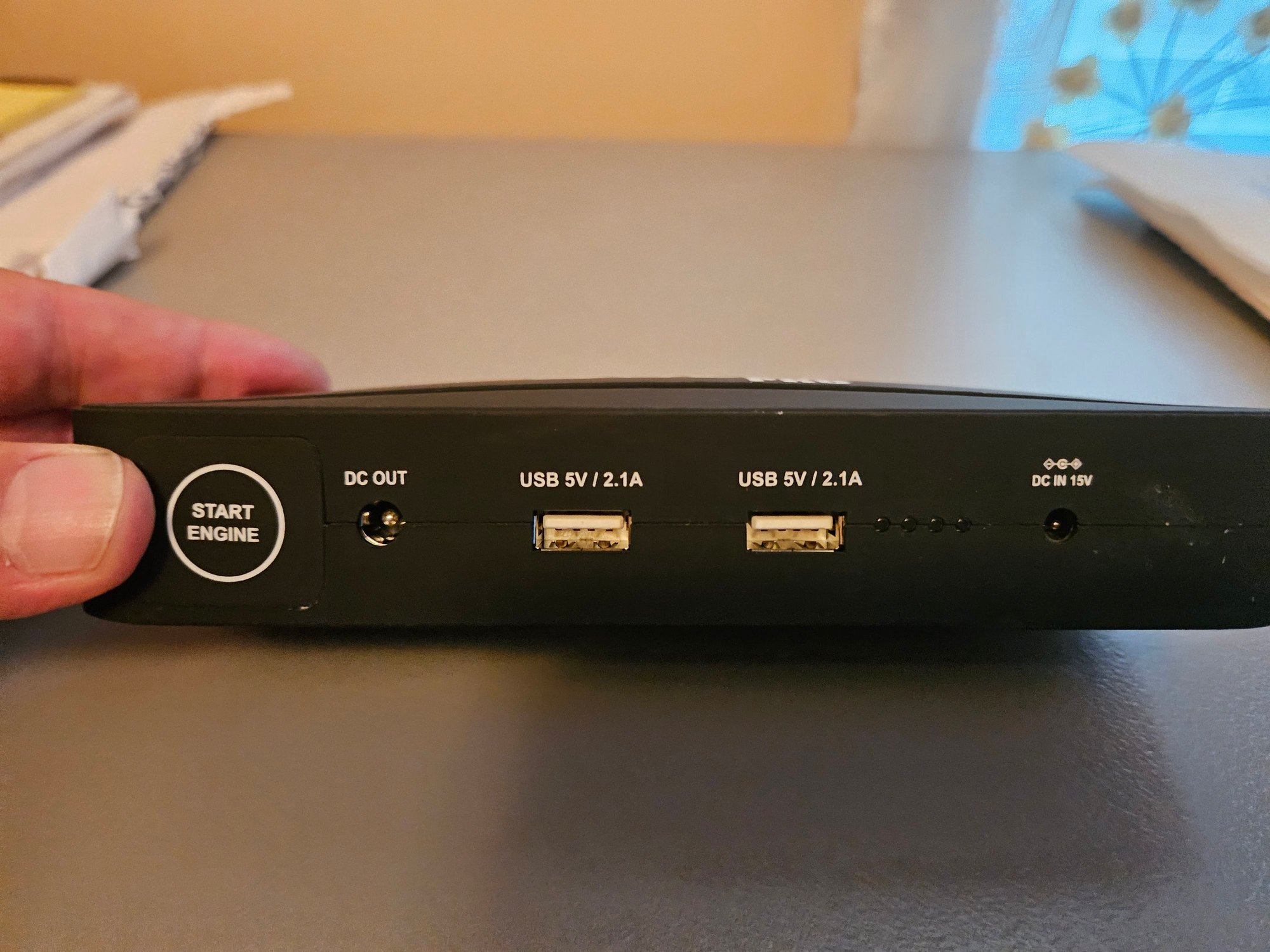

I carry a jump starter in my saddle bag and I take it out a couple times a year to check the charge and this weekend I noticed that the case was starting to swell up.
It uses lithium batteries and I don't need this thing to catch on fire in the middle of the night, so off to the dump it goes.

It contains a soft foil lithium polymer battery that has been over discharged or overcharged or sat in very high heat.
The do puff up and then they should be treated as explosive.
I would fully discharge it to zero volts and then toss it. Do not discard it with a charge as it can be lethal for refuge collection or land fill.
