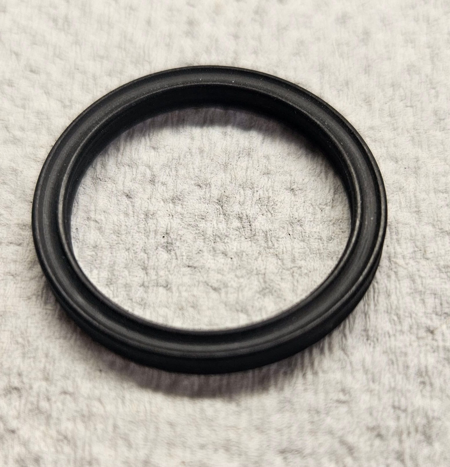

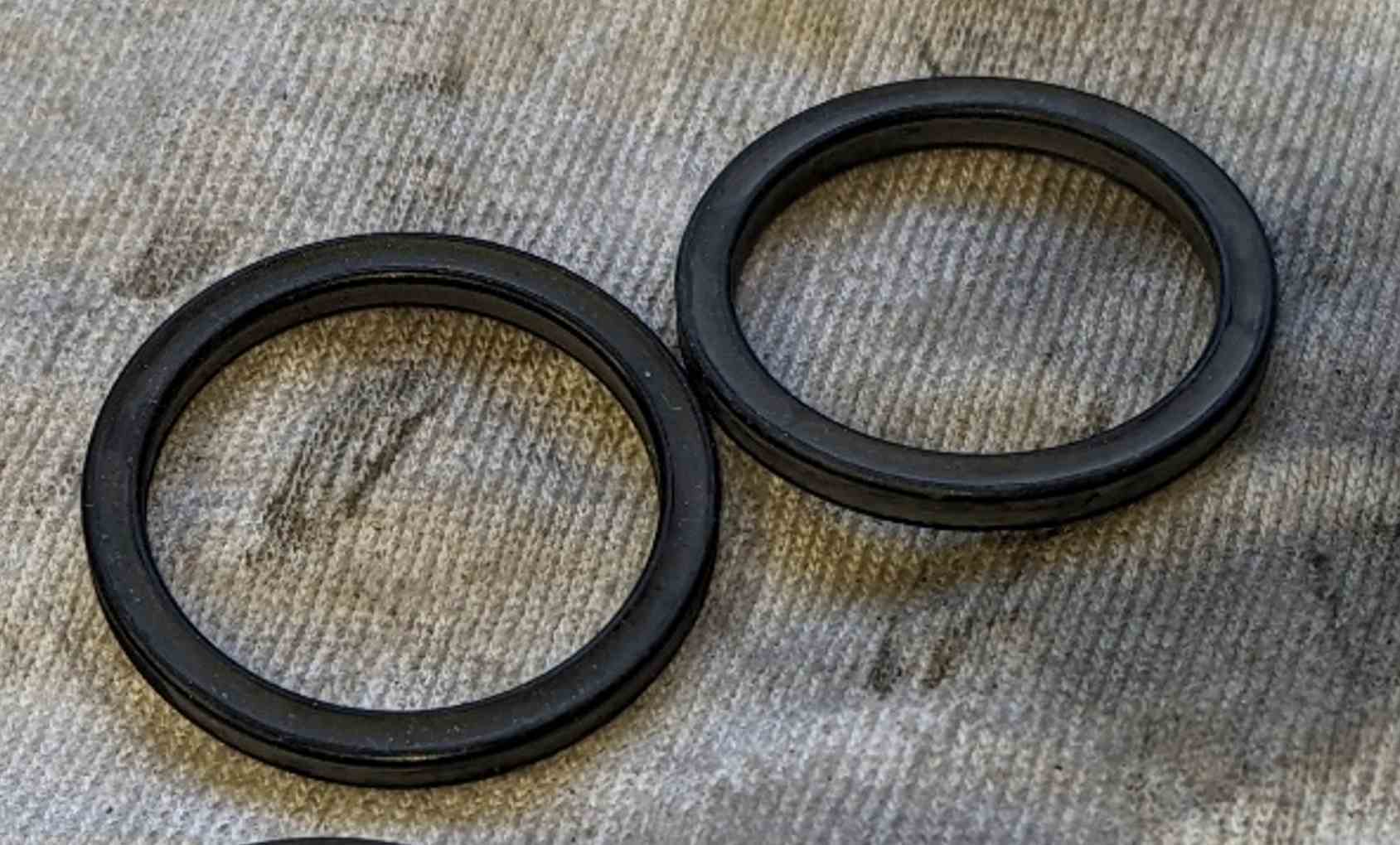

The bottom tube rings I paid a fortune for are not round but an "H" profile. First time I ever got those. Kinda tricky to install. I had to put them on the tube and use a dental pick to start the bottom edge into the lifter block.

If you really want these..
https://www.mcmaster.com/products/o-...ction-shape~x/
I got some in a james gasket kit IIRC.
Personally I've use the round O ring and never had an issue with the lower. I've had pushrod covers leak 2 times.. The first was when I tossed a little fork oil into the motor oil to seal evo rocker boxes. One of the middle pushrod O rings swelled up and started to leak.. It was a motor that I didn't assemble. The other was when I installed a cover clip against the head and not the upper pushrod. Upper one leaked.

Yeah, I've never used anything other than round profile o rings. And I really can't recall having tubes leak in the past 4 bikes, or 35 years really. But then again, I can forget what I'm doing while I'm doing it! These spapped in and there was some squish from the clips so I guess time will tell.

Thanks but I'm not sure I want any more right now. Guess they're more of a squared (?) "X" profile really and since it's the first time I've ever used them I'll wait to see how they perform.

yep quad rings can get pricey. unless the assy calls for them, o-rings will work.
that said, if you find backup rings with the o-ring make sure you use them or the o-ring is subject to early failure.
they usually go on the low pressure side of the o-ring and control squish.
