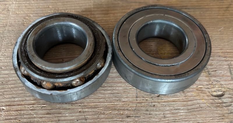

My 2000 wheel bearings had 113,000 miles when I pulled them out - kicked myself as they were actually fine but I was playing it safe. At about 6500 miles on my 08 the bearings went out front wheel and rear cush drive. Very sad how the quality declined once they changed the bearings.
