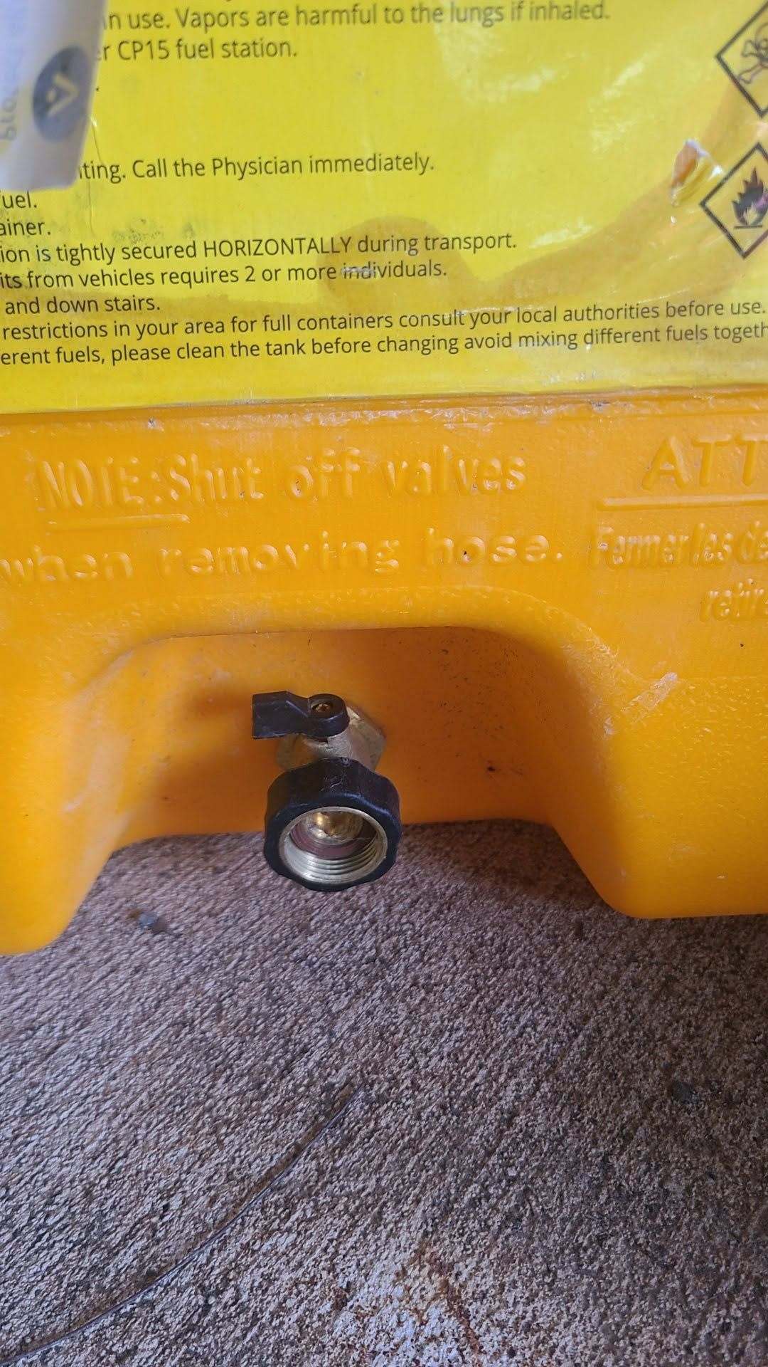

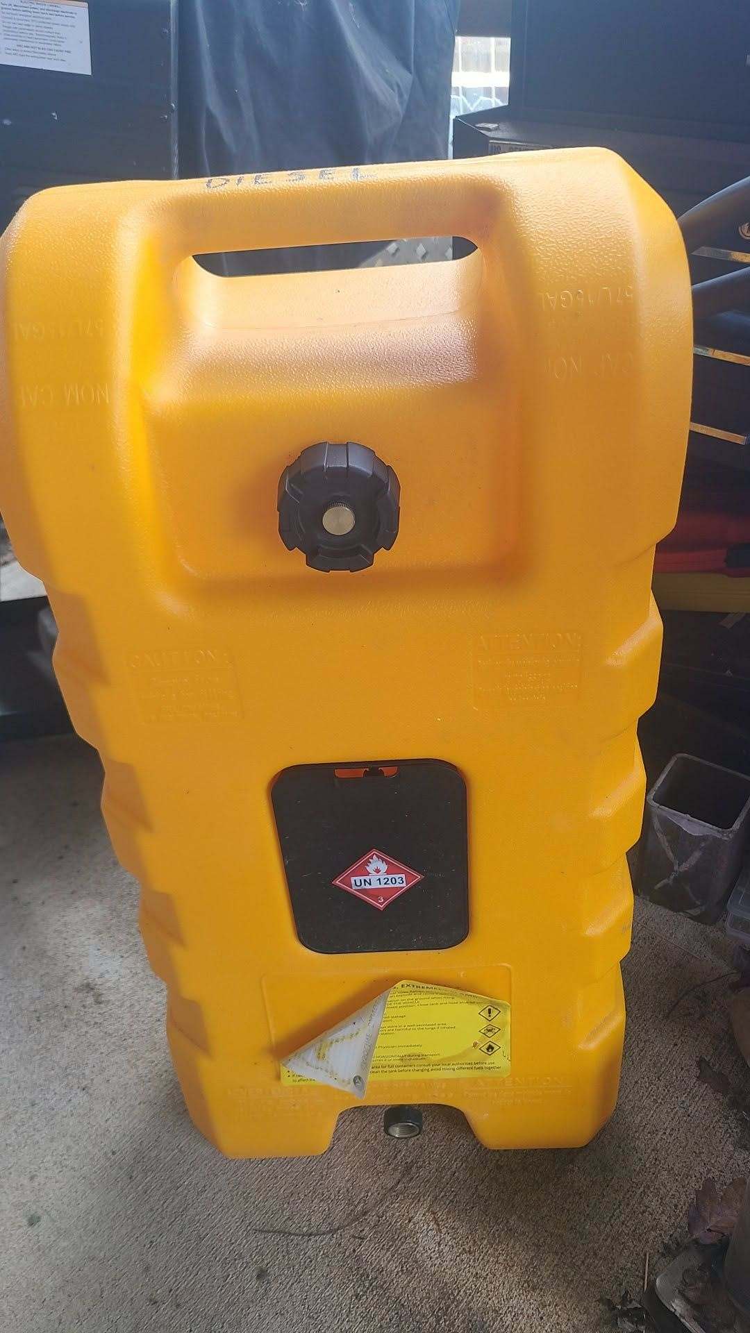

Originally Posted by Troublesome
Not specific to the bike, but for my shop.
Picked this up, and while it's diesel yellow, I plan to put clear premium in it. (it's bone dry now)
It's gravity fed, and wouldn't pour unless I move it onto the bike lift. So I was wondering if I should add a pump, or maybe an air fitting near the top to connect to low pressure compressor.
I am open to suggestions.
