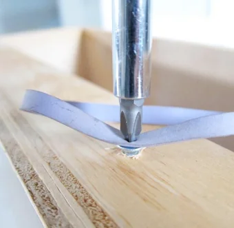

You could put over a rubber band to get friction with your philips screwdriver

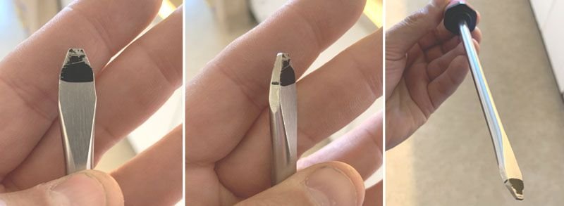

Thanks for you suggestions and inspiration. I managed to file down a larger flat screwdriver i found deep, deep down in my tool box.
And it worked very well, the screws came loose and I could check my air cleaner, change my throttle wire and learn how the handle-twist is assembled and works on my sportster.
