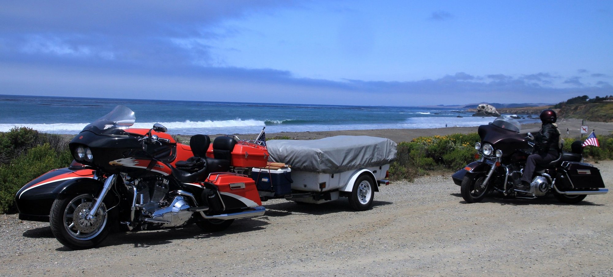

First choice would be a big twin, though any Harley can pull it. I have a friend who pulls a good size cargo trailer with an 883 Sportster, though that would not be my first choice.
I've pulled an Aspen camper all over the country with a 2000 Roadglide. For me, the best improvement for pulling the trailer was to drop the front belt pulley from 32 to 31 teeth, gives better pulling power without having to downshift as much.
I later added a sidecar to the bike, the knees and ankles just ain't what they used to be.
