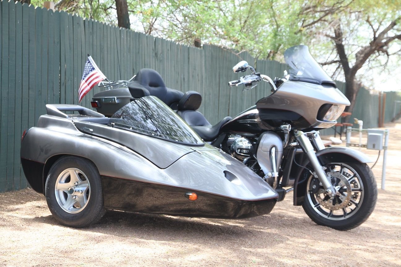

My wife and I both have sidecars on our bikes, love them. As Smitty said, there is a learning curve to driving a sidecar rig, it is a different animal than riding on two wheels, but once you get it, you will have a blast. We use our's for everything from cross country trips to runs to the grocery store for a month's worth of groceries. We took our two 30# dogs cross country in the wife's hack, and we have picked up the grandkids from school with them. Set up right, a sidecar rig handles just fine, mine is rock solid at 90, as fast as I have had it so far. Besides, sidecars are way cooler than trikes!
Hannigan Supersport sidecar on my '16 Road Glide
2000 FLTRSEI with Hannigan SP2 sidecar
The wife's '05 FLHT with Hannigan Classic sidecar
Beth's '05 FLHT with Hannigan Classic sidecar.
Did you change the tree’s on any of your bikes?
I have very little time on my rig thus far, I haven’t changed the trees on my Electra Glide Classic but I haven’t anything to compare it to

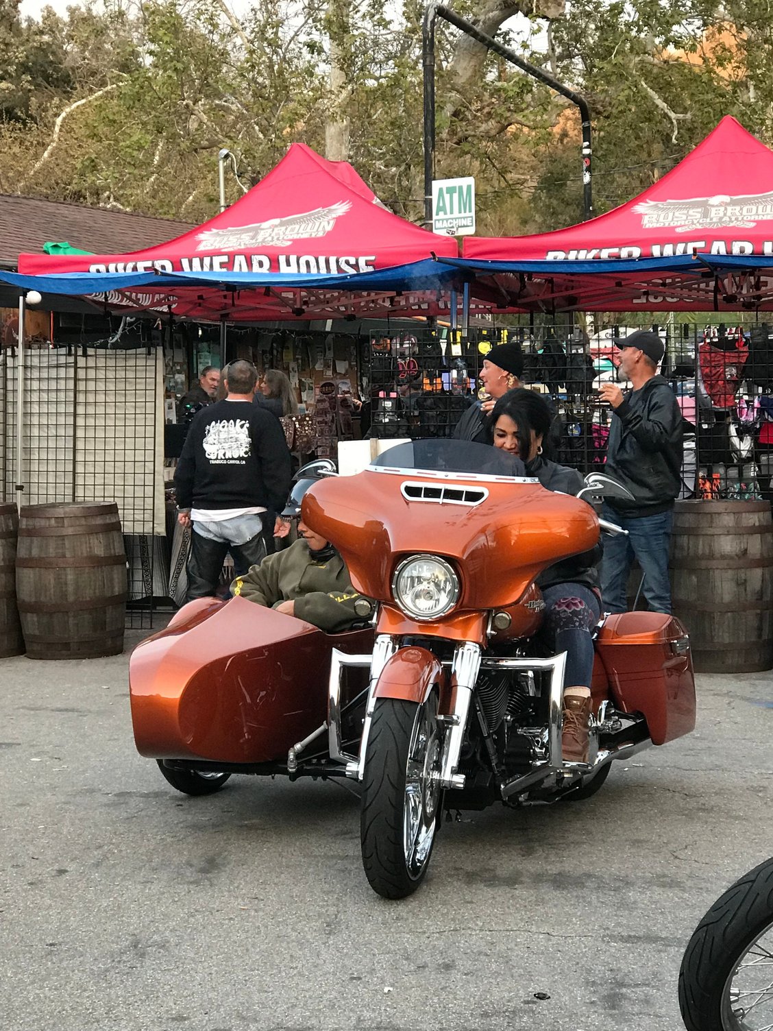

One of the wives in our group drives this .
