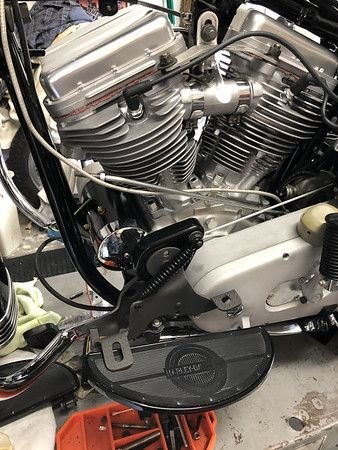

Just some information. Harley never offered a reverse as a factory option on any sidecar. Never.
They did on A few of the 3 wheeled versions .
Well, this here is factory shift gate and it is tied to a 65 Pan and sidecar.
...and up until the mid to late 70s, the transmission case for Big twin models was machined to allow for the reverse gear.
Starting 65, if you wanted a 3 + R the factory offered a different tranny lid as well as a shift drum and shifter gear (no mousetrap or ratchet lid but a hand shift foot clutch assembly)
"The subject has been well researched in the sidecar world and over and over shown that HD did not do a factory reverse on any sidecar."
I don't know but I'm thinking maybe you need to expand your world a bit.
