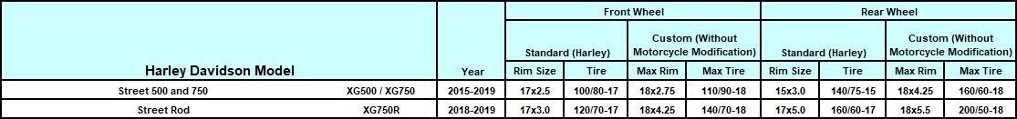

This is a bit more information that could be useful to some of you. So I'm assuming an 18" is the largest you can go on the front with the standard fender, can't see anything else stopping me from putting on a 19"X2.5"
