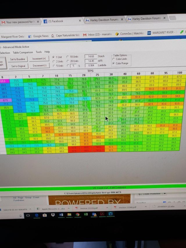

I have done a few flight recorder runs(5), and the cells in the tables are now mostly green/yellow.....is it still white(less than 5% change) that i am aiming for ?

Post a pic of your vtune results page and maybe we can figure what’s up with the colors.
Typically yellow indicates not enough data.

Hi Bob,
the front cyl is the 2nd photo.

can't thank the guys at tts mastertune enough for talking the time(8 mins) to help me out.
turns out I had turned the bike well enough, but wasn't reading the right tables.
