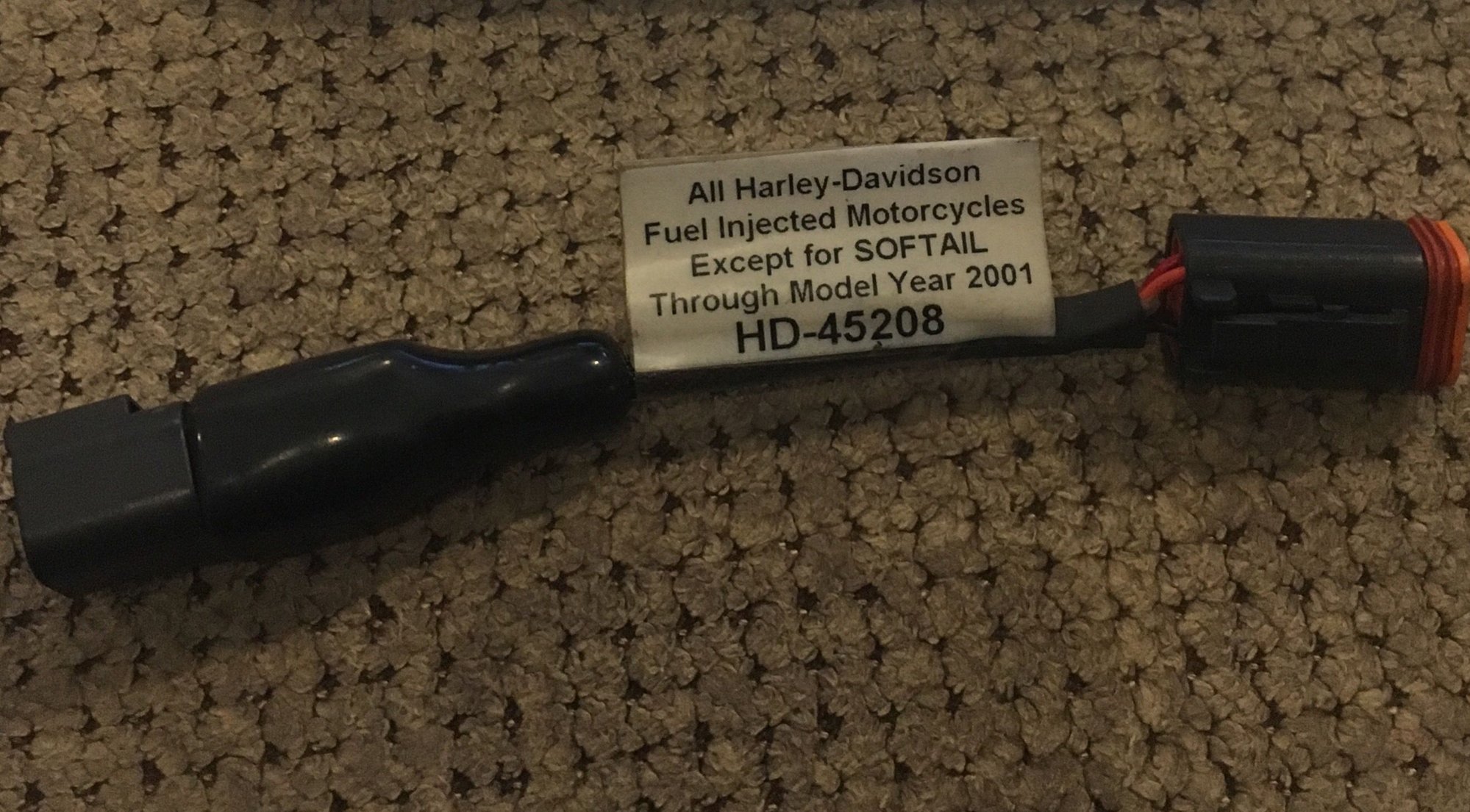

Yes - you need the adapter harness HD-45208 for communicating. Only other hope is full battery (keep bike on tender while attempting to talk) and/or just keep trying. Here is pic of one of mine.

The scanalyzer has always worked in the past. I even tried it on another bike and it worked. I believe something has changed on my bike in the wiring harness.
Never seen or knew of that adapter cable....what does it connect to?

Between scanalyzer and bike. Scanalyzers were hit and miss talking to MM bikes - that's why H-D has it.

I need one....can’t seem to find one online. Anyone have a source to purchase one?

I believe they are obsolete. They were through SPX Kent-Moore to HD dealers. You could try that - I doubt you'll be able to obtain one. Like I said, have bike on tender or charger when trying to talk. If nothing else works, PM me - I would be willing to sell my extra cable.
