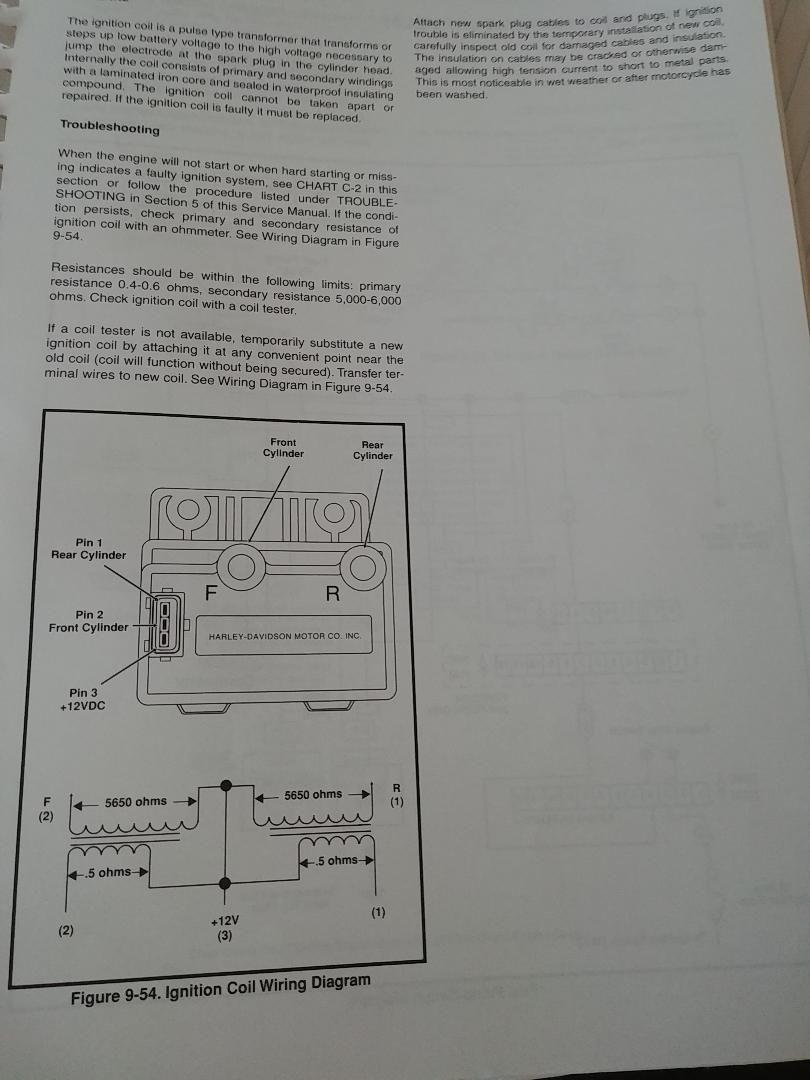

Old Jun 4, 2019 | 08:09 AM
larsfum's Avatar
larsfum
Joined: Jan 2009
Posts: 2,578
Likes: 463
From: On a Lake, not far from the Gulf
Here are the three pages of flow charts from the 98 SM. Walk through them. If it is the coil they should help. They are a bit out of order. The second page should be first and the first page should be second.

Max is 100% correct on the 12V+ not coming from the ECM. Also, it one cylinder has spark, the coil has the 12V+ signal. You are looking at the ground side for your problem. From the descriptions above, it appears you have one of several things going on. 1) Bad new coil, 2) Bad aftermarket fuel/ignition controller such as a powercommander - you say you do not have, 3) broken or corroded wire between ECM and coil, 4) Bad ignition module in cam cover 5) Bad ECM, if that's the case and you cannot find one pm me.
You will only have 12V+ to the coil when the system is powered up and the crank sensor sees a signal (except for key on). You will most likely see it for 2-3 seconds at key on and it will go away if you do not crank the engine. When you start cranking the engine and the relay powers it back up, you will see it again.
