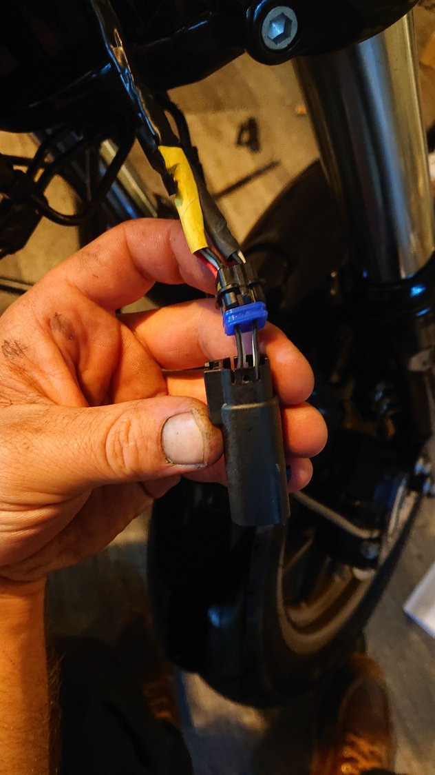

So it was running fine then all of a sudden out of nowhere the TBW error came up?
Find the TBW connector in the opening by the steering head. It’s a small 6 place connector. It looks like this.
Disconnect the two. Look at the handlebar side (side with sockets, not pins) and I’d bet one or some of the wire socket connectors weren’t seated properly and pushed back in the housing. It’s real easy to wreck the internal retainer clips if someone depinned it to make pulling it through the bars easier.
I’ve given up on reusing them. Once I depin it, it gets tossed, and I use a new one.
And really, really hopefully, whoever did the job didn’t cut and solder extensions in it... If so, toss it and buy a new TBW and a proper extension cable.
Yeah that little six pin connector on the tbw side was mangled to ****, and the white plastic clips on the end of the throttle twist were practically sheered off, so I bought a new tgs module.
The problem now is that the new connector is different. I can't reuse the old one because the wires are toast. Where do I get a new connector that fits the fxdls?

I’d be very careful. You have the wrong TBW sensor. That’s not for a LRS. Who knows if there are calibration differences between models. And/or pinout differences. I’d get the right one before f’ing around with changing connectors.
