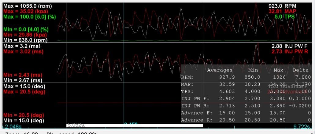

Just to add a couple of MLV traces if you're interested First is with no idle spark control, the second is with the 824 defaults (-9.96). As I mentioned, this only became noticeable after putting an Andrews M462 in, with stock exhaust
0/0 Idle spark control (positive numbers pretty much look the same)
Default -9.96/12

I believe those setting are to control idle to hit it's target.in the closed loop system. With it on you are trying to control idle with spark and air. With off, just air. Look at your throttle blade movement comparing the two. Surging at idle is usually lean idle surge. You could try a richer mixture at idle to see if this is the case.

Thanks for that, took a wee while but went out again and tried 14.0 instead of the stock 14.6 in the lower 9 blocks of the AFR table, but that didn't change the results any. It definitely looks as if it is that negative number in the Idle Spark Control Gain
It's quite a nice prup prup prup prup sound, but not sure if it is a good idea or not. I'd be more keen on a smoother idle although the idle variation ultimately looks pretty similar.
