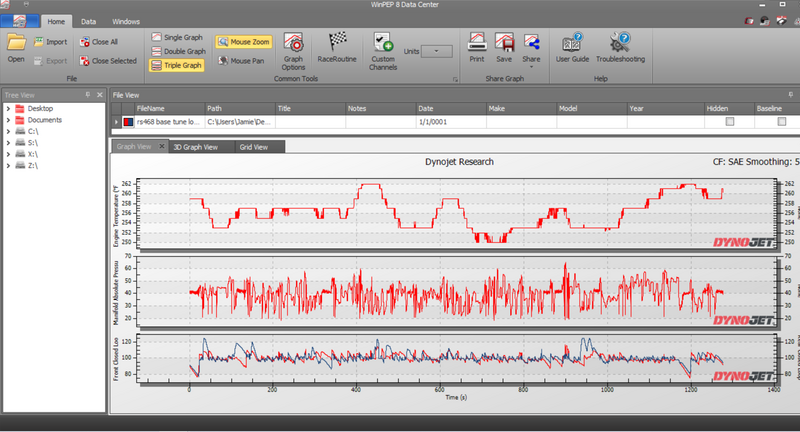

What do you guys use to view Powervision logs?
I have been opening them in excel.

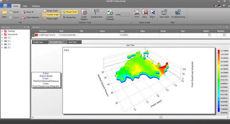

The easiest way to view Power Vision logs is with the Dynojet Power Core software. PV logs channels are defined so its as easy as opening your log and selecting the channels you would like to view, you can view them in chart form or in 3D. You can download the software for free here>> https://power.dynojet.com/api/object...lease/Download
