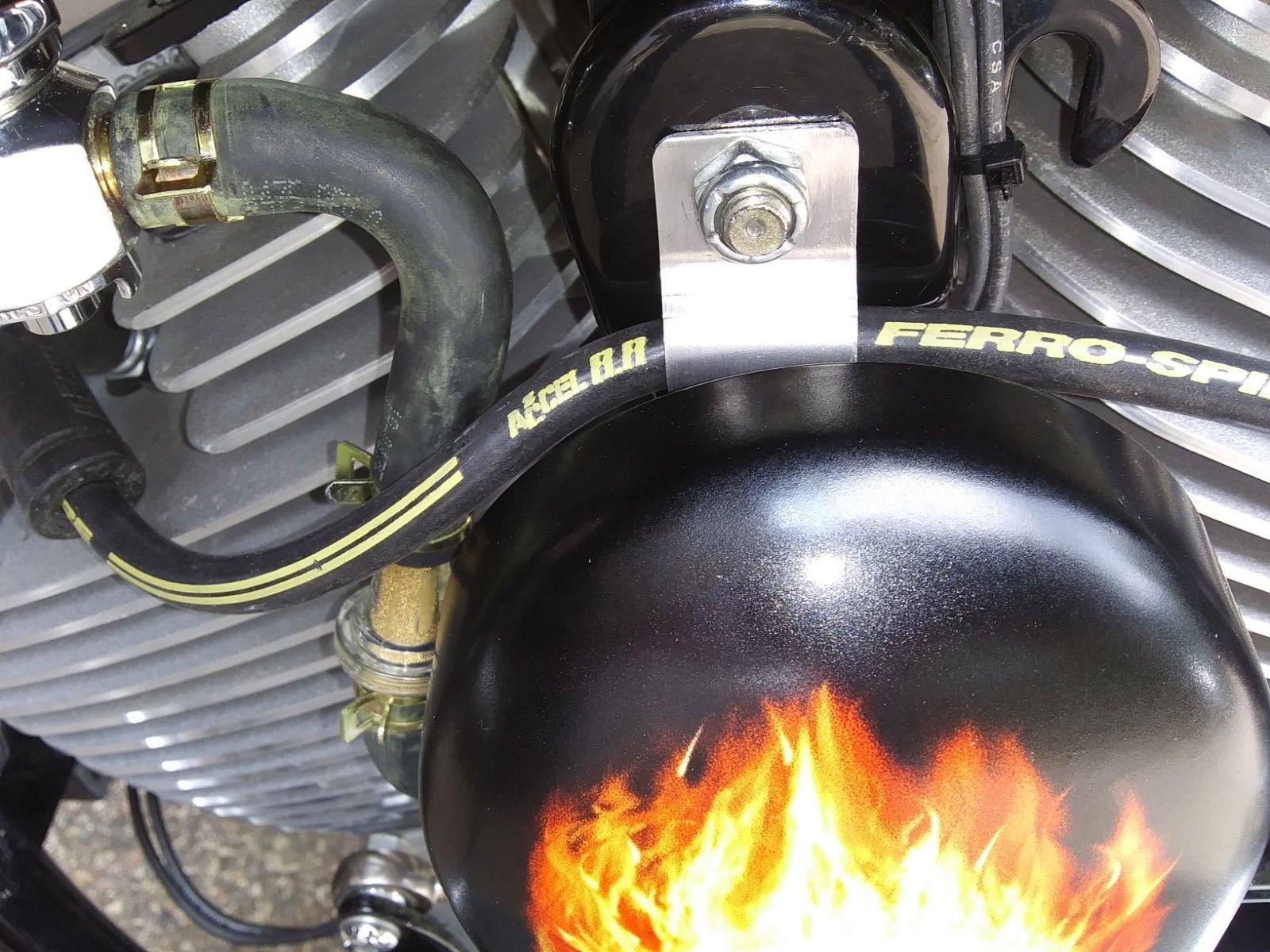

Made this clamp for my plug wire out of aluminum, question is will it have any effect on the spark? I have read where if you use metal to make spark plug wire separators it will have an effect on the spark.This was on a car.

Won't hurt a bit unless wires get old and broken down by the sun .
I personally would fine a scrap of #8 3 wire. Cut and split it for a sleeve . Snug or black RTV to stick it.
When all is good, flat black rattle can it to make it disappear.

Won't hurt if you keep good wires on her, they get old, hard and break down a bit the spark tends get out

Dip it or coat it, the vibration will compromise the insulation on the wire after a while.
That's why all plug wire supports are coated or plastic.

naw, metal looms have been around forever and just about any color to match the under hood. if the metal crosses the wire at 90* then you do not have to worry about emf, only when you run in parallel will you get magnetic induction.
that is a good reason to always follow the mfg original routing especially on computer controlled vehicles.

Maybe an aviation type clamp:
Clamps

I have a nice assortment of various size and gauge shrink tubing I've gathered over the years I use to insulate odds & ends like that. Ebay commercial surplus is a treasure trove for this kind of stuff cheap.

I know on small block chevys(first generation)that a couple of the wires have to cross. My curiosity never made me seek out why but now I know. Thanks
