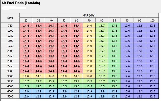

Hello all just wondering about thoughts on my AFR table, it's from a 132 Breakout and using Powervision Tuner, any help ,much appreciated, also do i need to retune Ve tables after modifying the AFR?

If your not looking to keep in closed loop much it a little to the rich side of things and may be a little lean at WOT for peak power

Thanks for the advice, i modified the table to this now.
