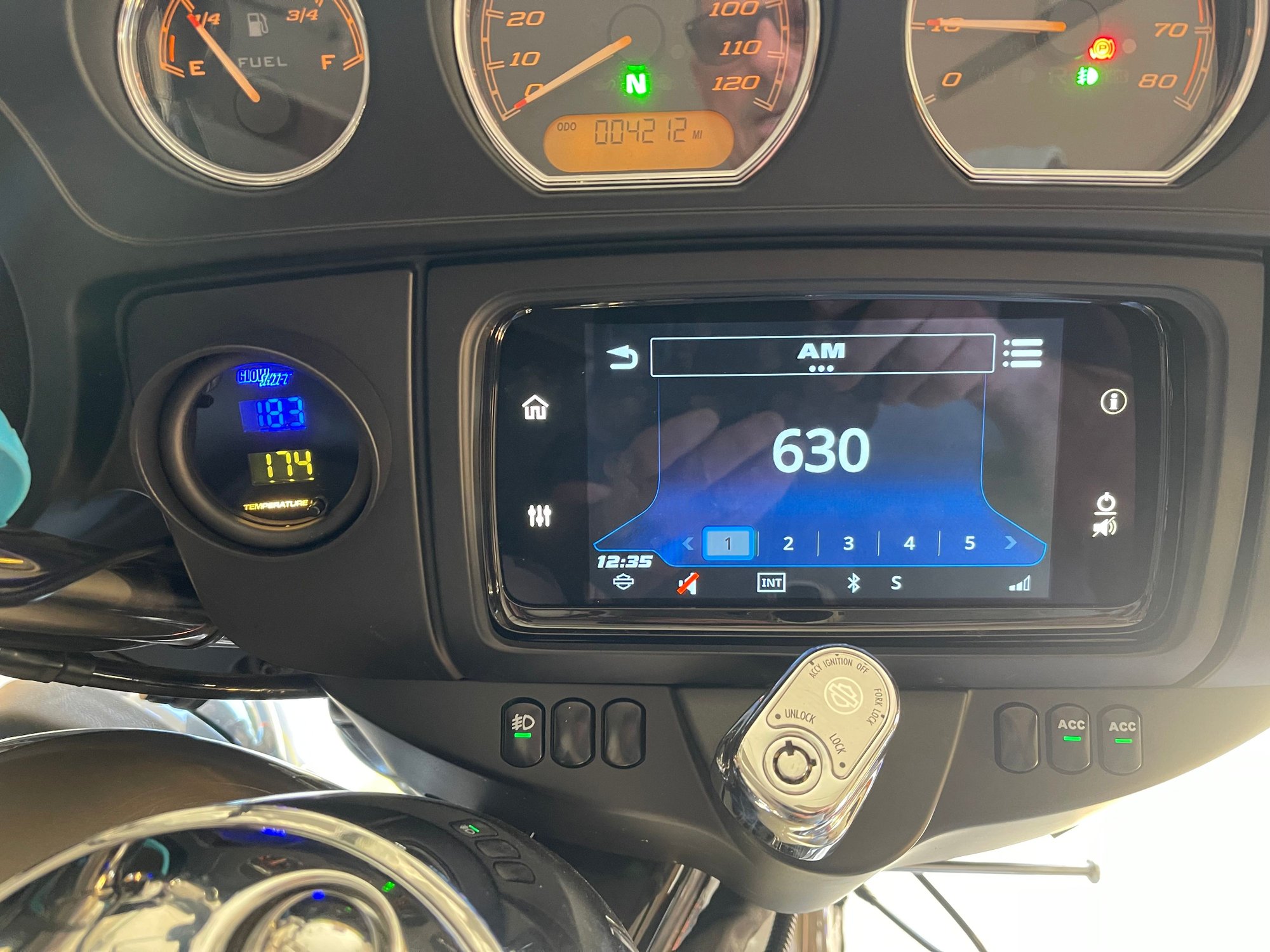

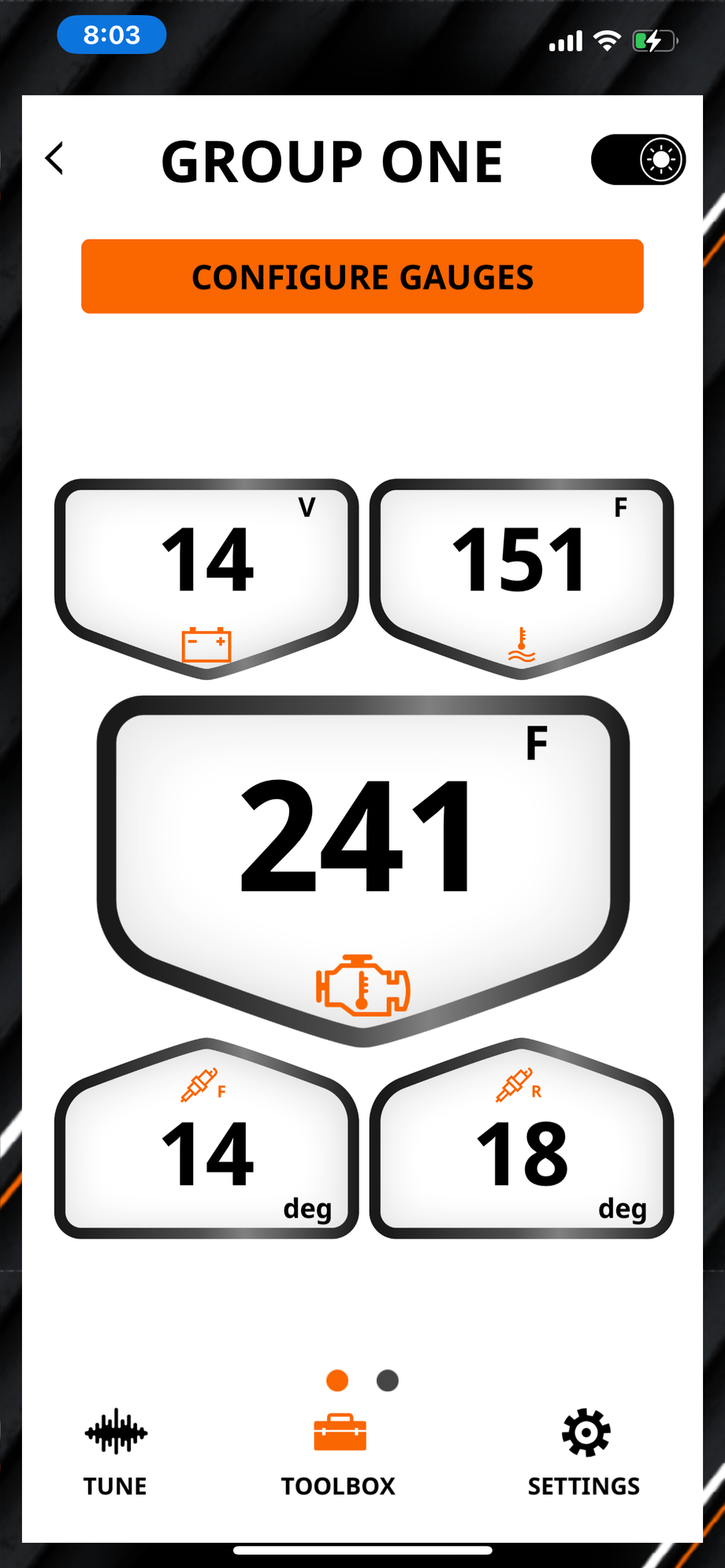

I’d love to have a free Data cable, but I doubt that will happen, but I only use it with my phone mounted on the bike to see the data live. I need to see head temps, even though they are now liquid cooled. I have an issue with Harley not showing info that is critical to the engine. They don’t show coolant, oil and head temps, the most important data that they should display for free. I installed a coolant and oil temperature sensor to go with head temperature displayed in the App.
The gauge is showing in blue coolant temperatures and gold oil temperatures.
This is a screenshot of my SE pro programmer showing engine temperature and intake temperature as well as other parameters
