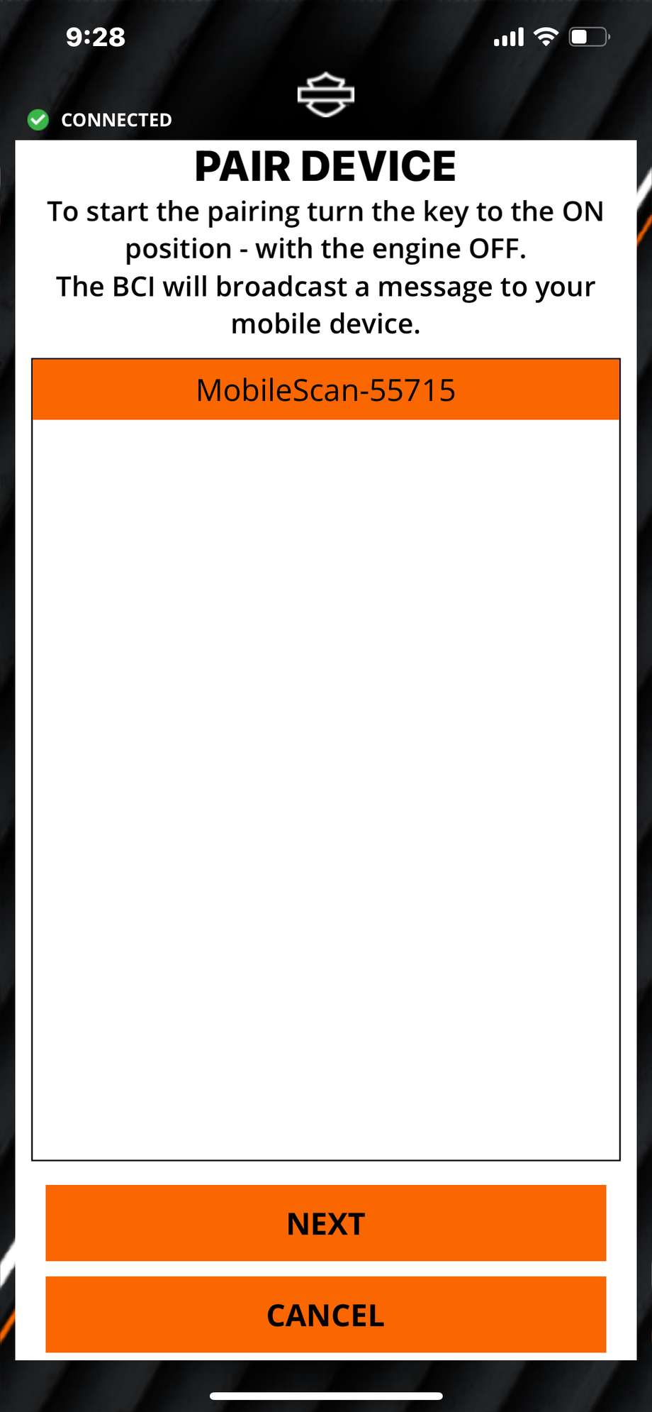

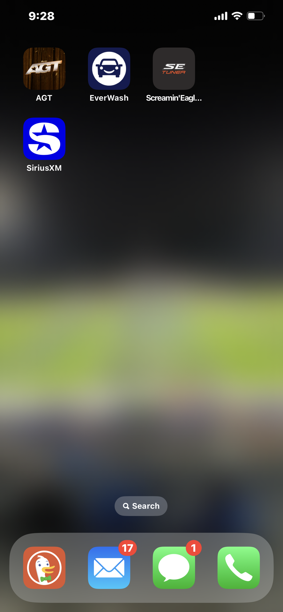

I downloaded the iOS app today, but the app would not pair with my bike (screenshot attached). App indicates that BCI is paired to a different motorcycle?
I got things to work this morning by reseting the SEPST using the directions in the Mobile Tuner User Manual:
3.Unpairing:
To unpair the motorcycle, if receiving the message “paired to another mobile device,” follow these instructions: Turn the ignition off for 30 seconds. Turn the ignition on with the engine off, then quickly turn the twist grip to 100% and back to 0% repeatedly until the LED performs a series of quick flashes. After that, the LED will begin to flash at 1 second intervals indicating the BCI is waiting to be paired.

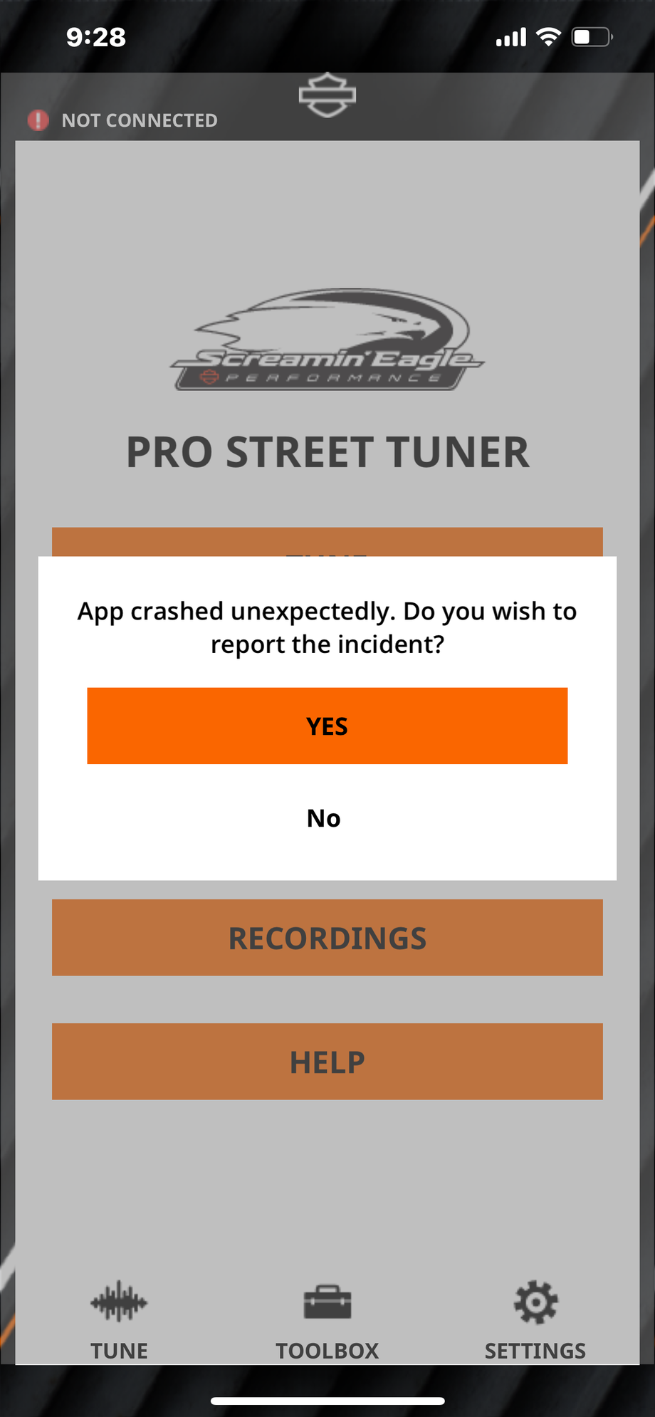

Thanks @triplespeed, I finaly managed to get the App working following your recommendations. I got it working, and warmed up the bike and went on a ride. When I opened the App, after restarting the bike, it crashed. It kept crashing when tapping the NEXT button, finally started working after several attempts. Then would crash again after restarting the bike. I bet there will be an update soon for this issue, it gives the option to report the crashing.

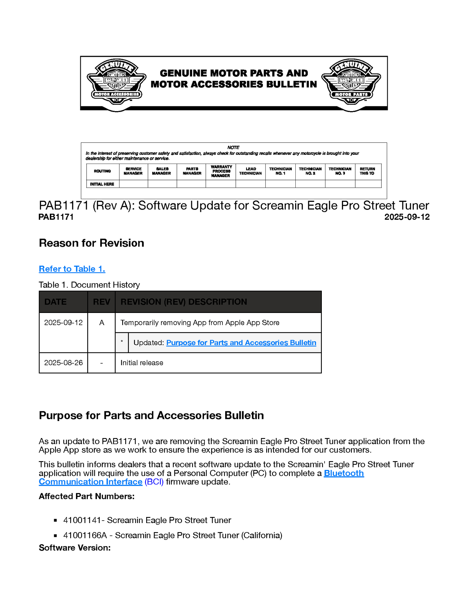

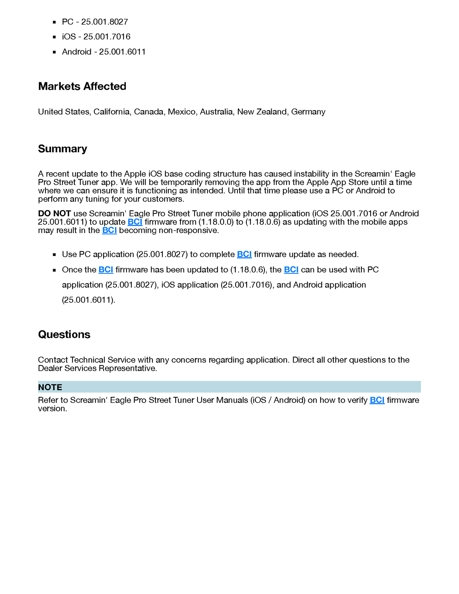

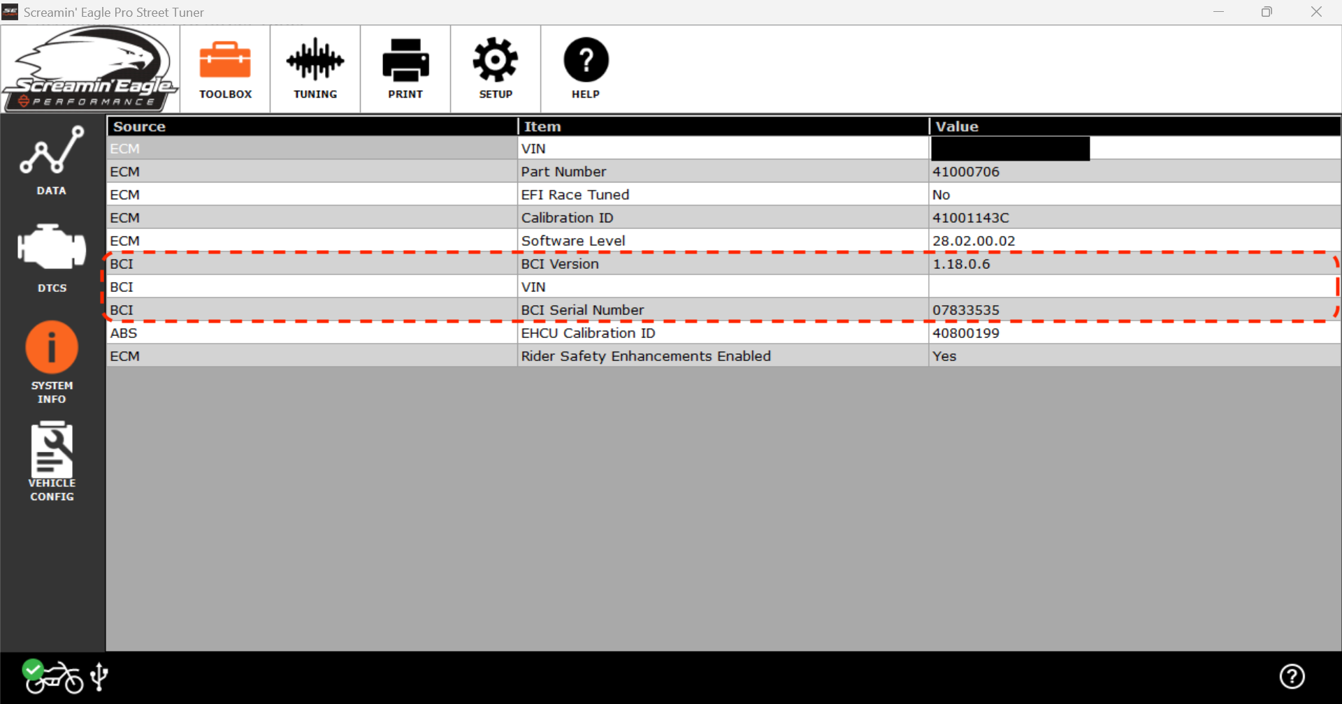

Recommend confirming that your Bluetooth Communications Interface (BCI) firmware on the bike has been updated to (1.18.0.6). The P&A Bulletin PAB1171 (Rev A) from 2025-09-12 indicates that BCI 1.18.0.6 is needed to resolve instability in the SEPST app, and that you must perform the BCI firmware update with the PC app -- not the iOS app. Hope this helps!
Old Oct 19, 2025 | 04:58 PM
RVTRKN's Avatar
RVTRKN
Posts: 189
Likes: 49

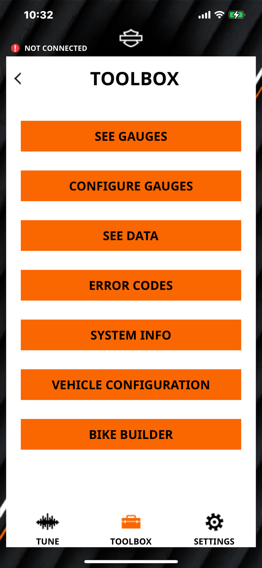

Yes it’s updated to 1.18.0.6 so here are the steps I have to go through to see the gauges.
What doesn’t work
1st
2nd
3rd
Old Oct 21, 2025 | 10:56 AM
RVTRKN's Avatar
RVTRKN
Posts: 189
Likes: 49
Sorry it took awhile, but here is how I get it to work. Open tool box and select “See Data”
then go back to toolbox and select gauges.
