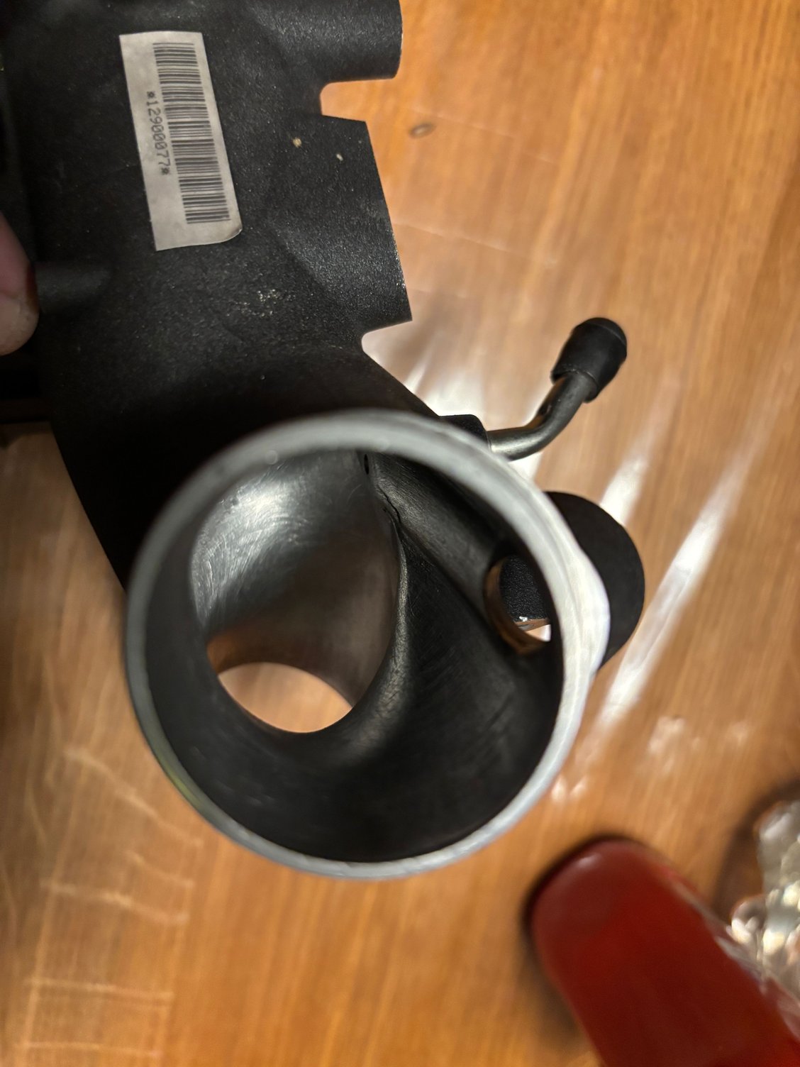

Just noticed that the throttle body on my SE110” have some sharp edges from the casting inside.
Can this restrict the flow, any gain in removing these edges?

Absolutely. Round them, remove that flashing.

You are talking about polishing.. I agree, not a good idea. Hasn't been done for a long time.. The issue is that that port looks to have a step. Not good. The best thing to do without a flow bench is to make that lip go away and make it a smooth wide radius.. Leave the surface rough with a 80 grit sanding roll to create a boundary layer to keep the flow from tumbling. Sharp edges are not good.

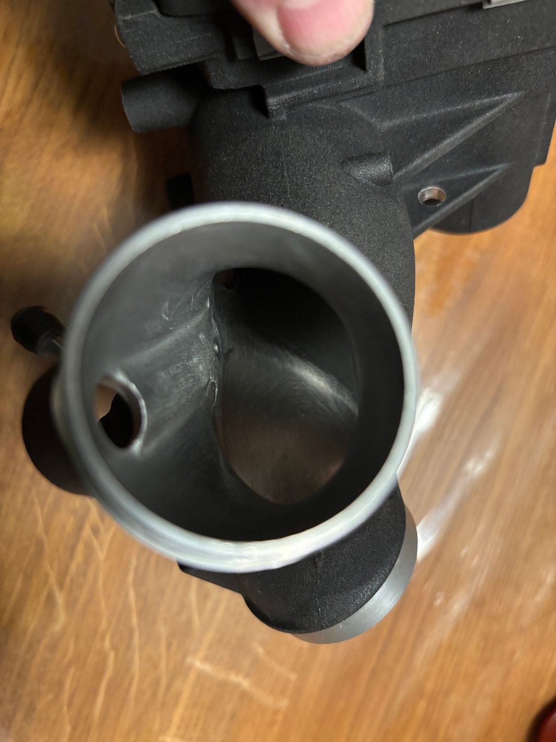

Made a custom bent round tool file to reach the edges and smooth it out with 80 grit paper.
Didn’t want to remove too much because it is rather thin material.
