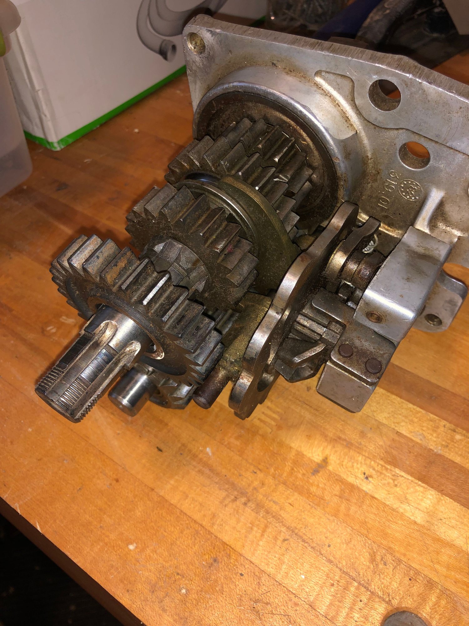

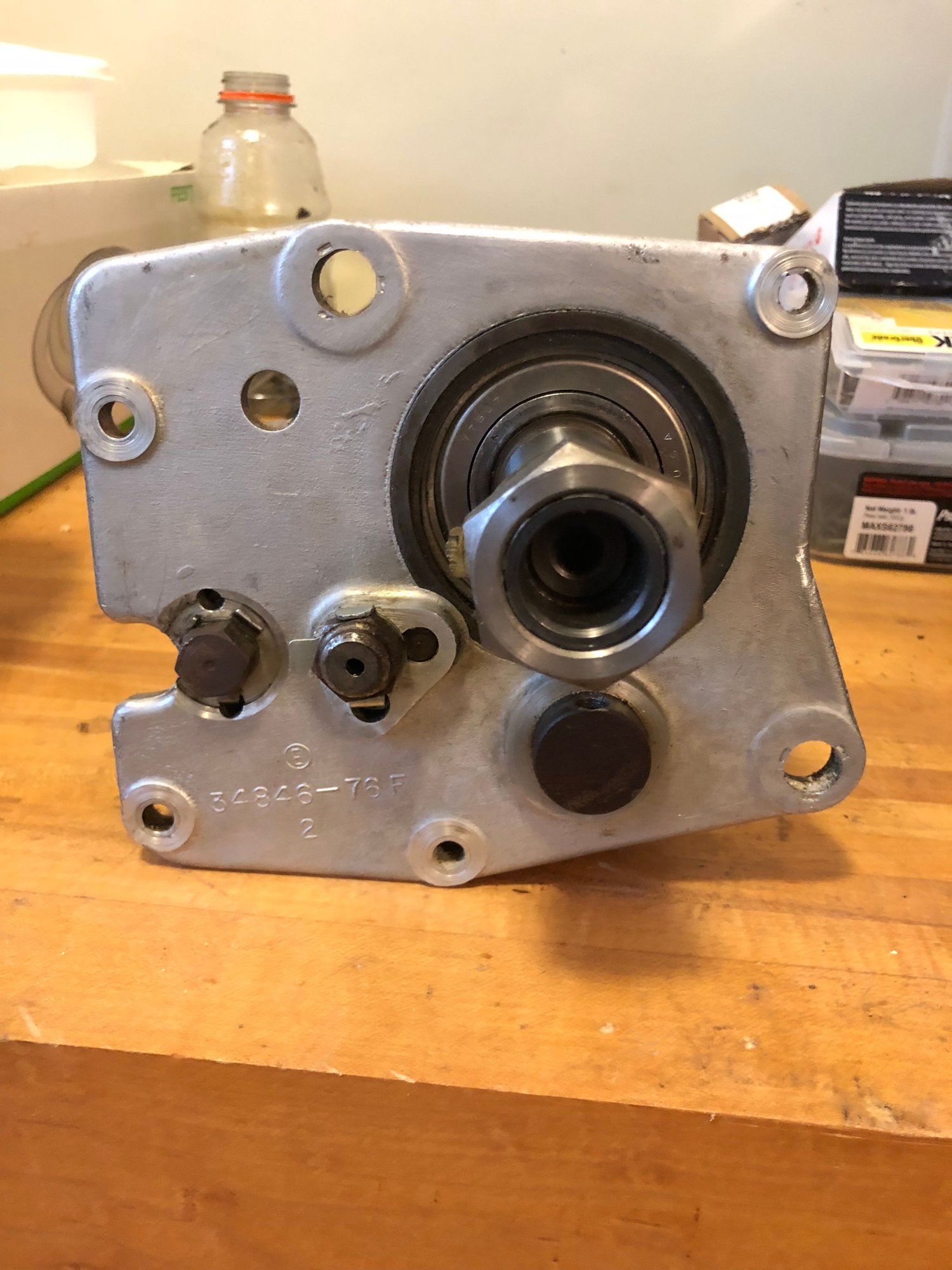

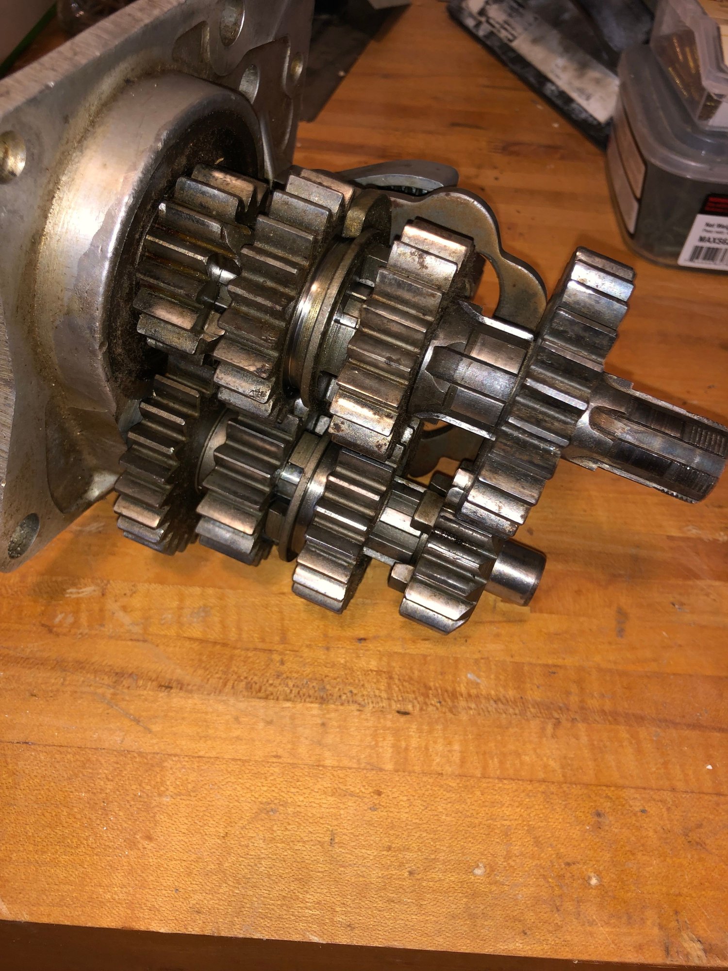

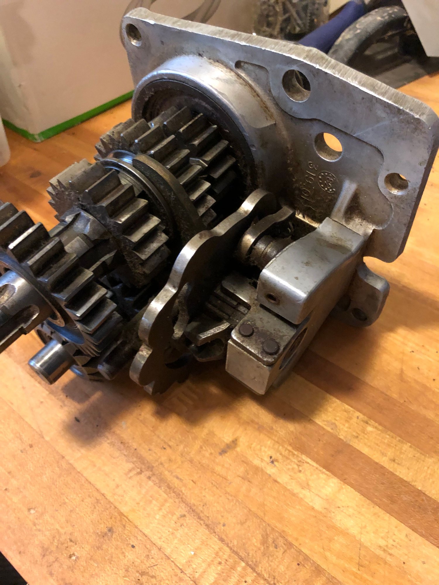

So I originally posted this in the transmission section of the forum and another member recommended I post it here to get more precise info. I’m trying to ID this transmission and figure what years and models it can be used for. In the transmission section they said it was a four speed for an ironhead possibly left hand shift. Can anyone provide me any further info about this transmission. As a note in some of the photos thie transmission is flipped upside down looking at the bottom side of the gears.Thanks much in advance. Matthew

that is a left shift unit they made between 1977 and 1984 the last series of iron head trans

I agree with johnjzjz. The U-shaped cutout in the first 3 pics is for the shifter shaft, which must then be on the left side.

if you look mick - in the photo of the shift selector you will see the late spring attachment for the shift forks - 77 /84

Yup; Ironhead trans, 4-speed. I've been working on these for three months, have two sitting on my bench right now. 'Shimming" the thrust washers is a pita, but parts are still available.
