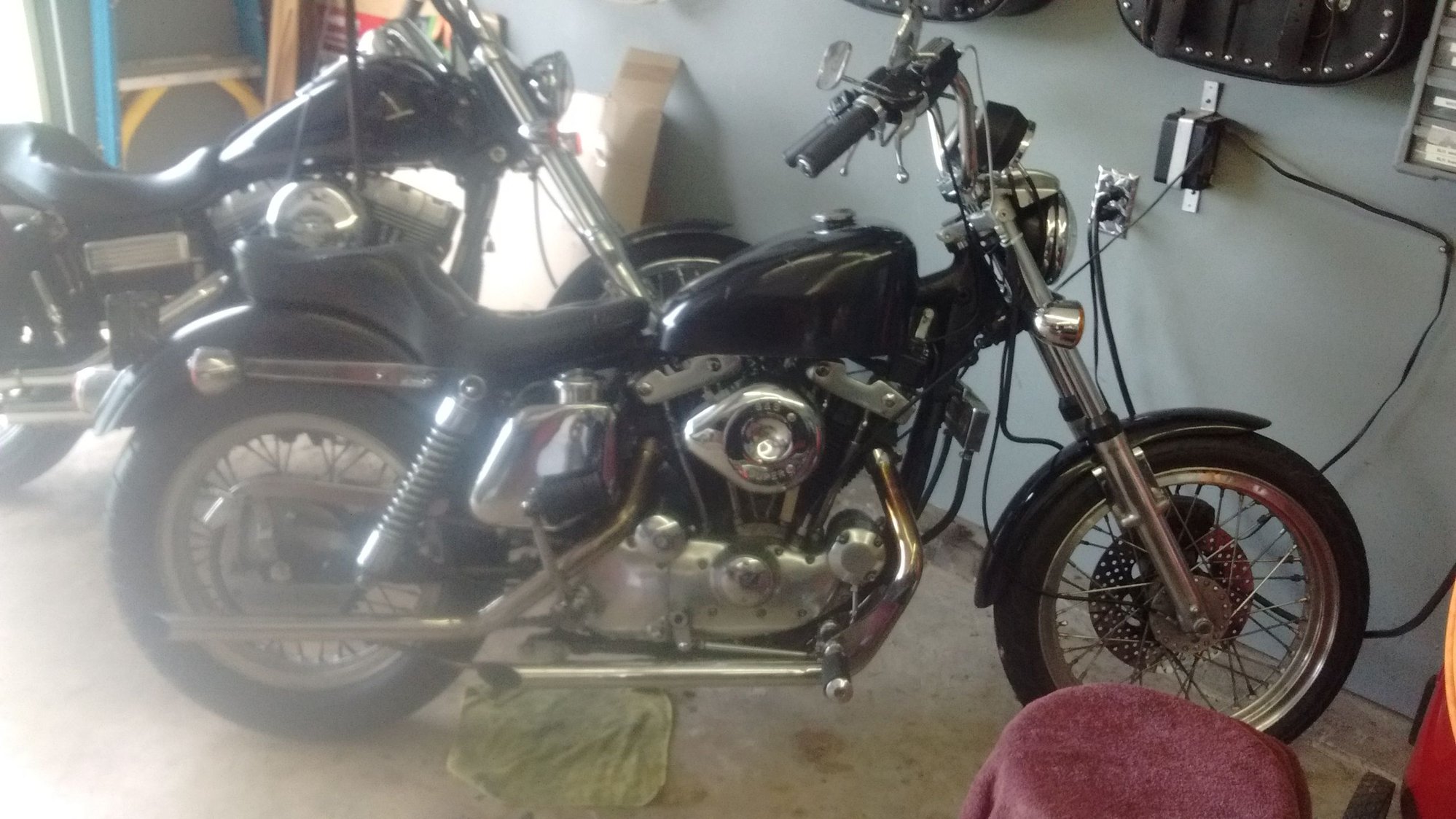

Got a 77 XLH with kick & E start. I'm 71 and really enjoy the E start now.

Nice bike, That is close to what I want mine to look like when I am finished. Ok. I hjave only been kicking it when it is warm. Using the e-start when it is cold.
