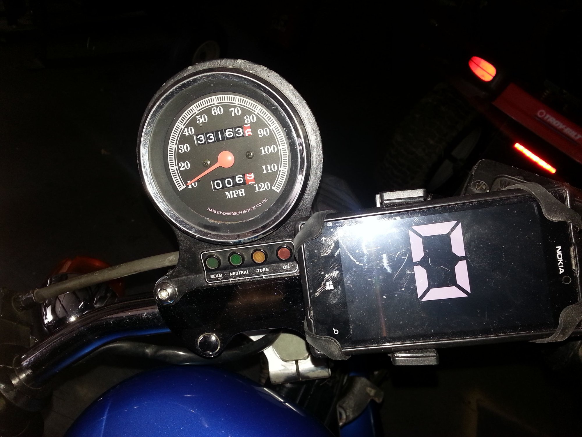

OOps sorry about the size. you could download DigiHUD to your phone, then beg borrow or steal and even buy a handlebar phone mount their cheap. Just a suggestion.

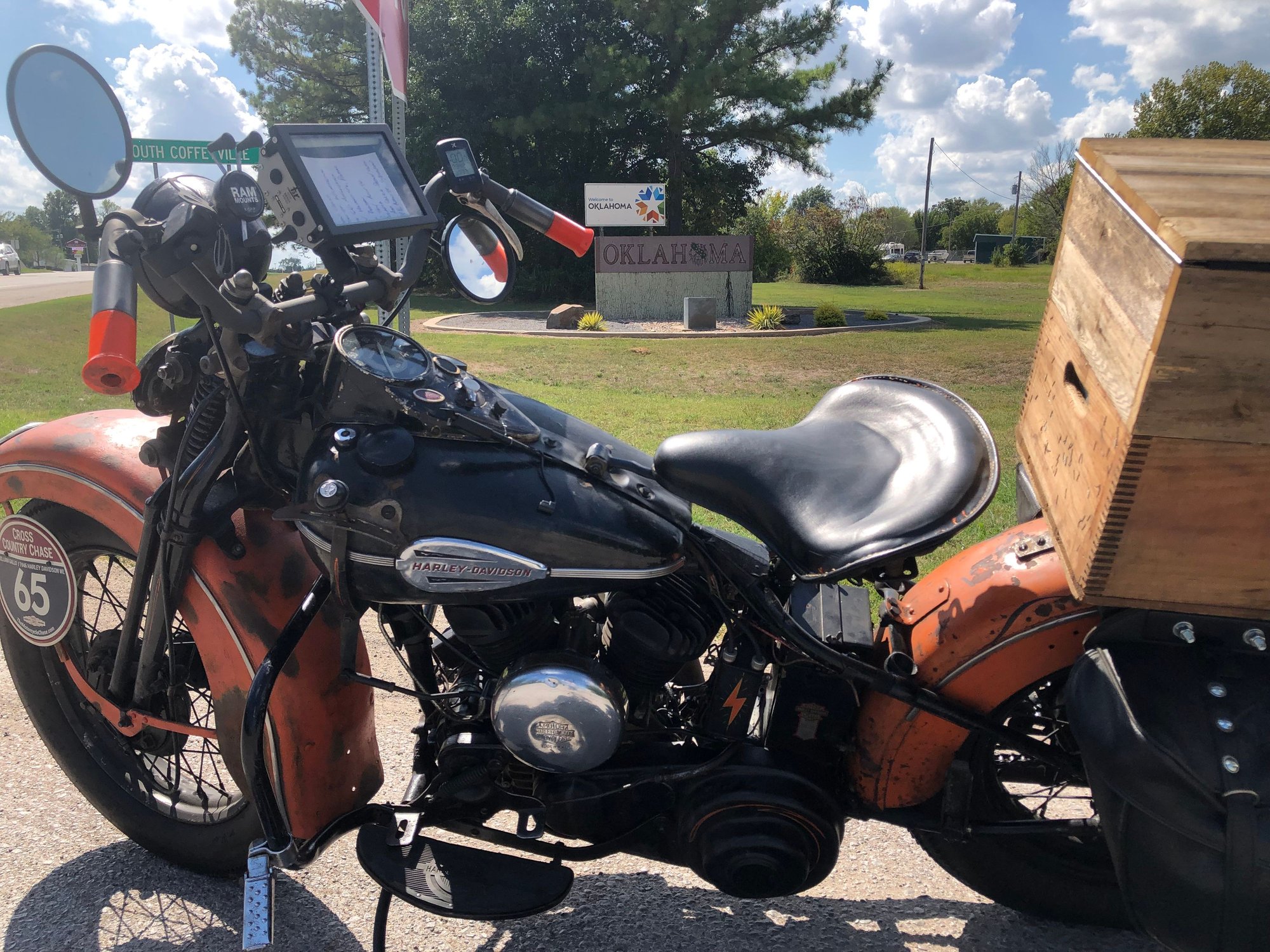

Above my mirror you can see my GPS speedometer that I used on the Chase. It is made for a bicycle, worked great for over 3k miles. Rechargeable, lasted about three days between charges. Also waterproof. Mounts with a supplied rubber O ring and base, takes about 10 seconds. About $40 on Amazon XOSS G+ Bicycle Odometer:. Get it installed, take note of RPM's at certain speeds, then take it off. or keep it on. Has some other functions but I only used the speedometer and odometer, it was very accurate. Good luck.

The speedo drive tab has been straightened and aligned with the corresponding hole in hub; speedo working great now! Up here, 3000rpm = 100kph. Thanks for the responses
