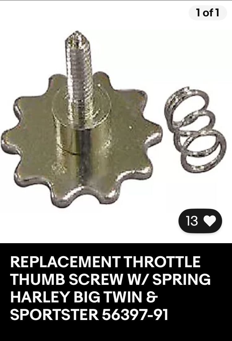

Is this the correct throttle thumb screw for this bike?
