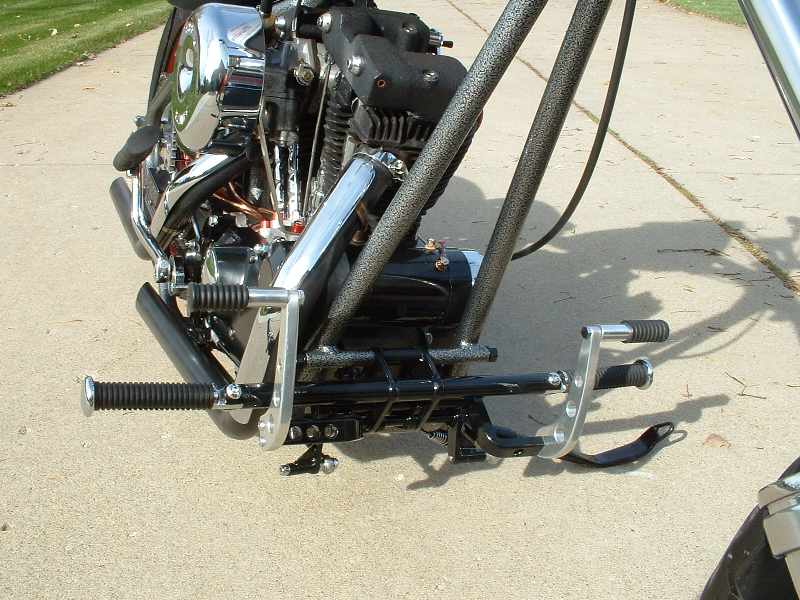

I recently purchased a 74 ironhead with custom designed forward controls that achieve the actuation swap you're looking for . They're a pretty nice piece of engineering. Here's a pic but it's hard to pick up much detail because of the black powdercoat.
They mount off the front motor mount point. I can sketch up the basic design if you're interested.

Yeah, the mid-seventies cross-over hardware is awful. They used the brake crossover shaft to move the shifter over resulting in a shift lever that is as long as the 69 brake pedal and not a thing of beauty.
Depending on how close to stock your bike is, you can do a much nicer job of swapping the controls yourself, as I did on my 61 chopper, by running a tube up by the motor mounts.
If your bike's anything near stock, though, stick with the original set-up. You'll get used to it soon enough.
