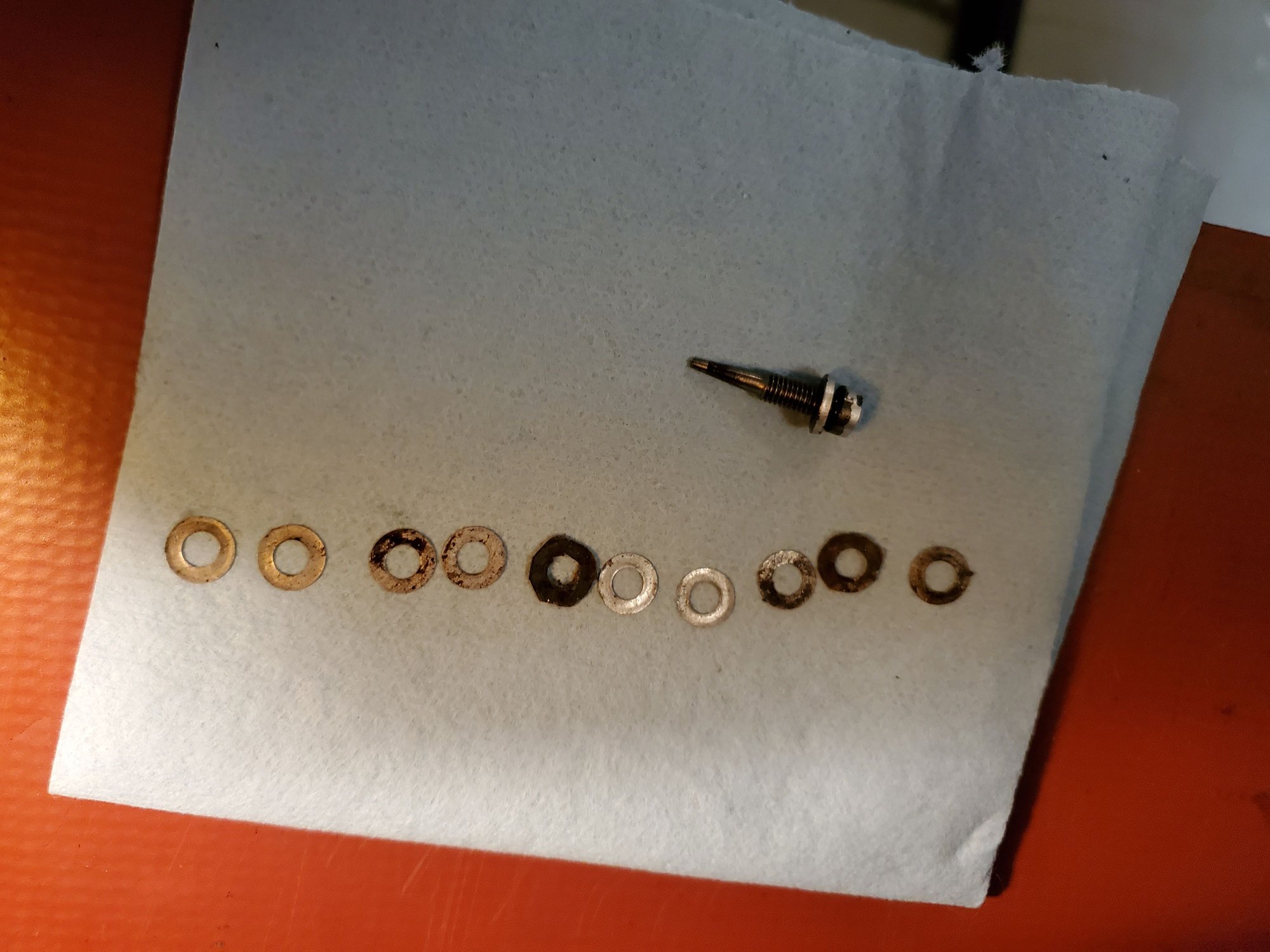

The screw has 9 .002 shims, one fiber type shim and the washer. Fired her up cold and there is return oil to the tank but at the oiler it's about a drop every 2-3 seconds. Yikes. Shut it off as it was making a mess. Researching what to try next as something is definitely amiss......

Update...........I installed the screw and gently tightened until it bottomed out on the seat. Then, tried to put the washer in the gap that was left. No go, which means with just the washer, the needle is off the seat. I worked it with shims until it was essentially closed off and still over oiling. Johnjz, I'm not understanding what difference the check ball and spring would have on the situation??? I've studied that oil flow diagram in the service manual until my brain hurt. If I understand it right, the primary chain oiler is just downstream from the line that feeds the timing gears. Is this why people convert to belt drive? Har.........
