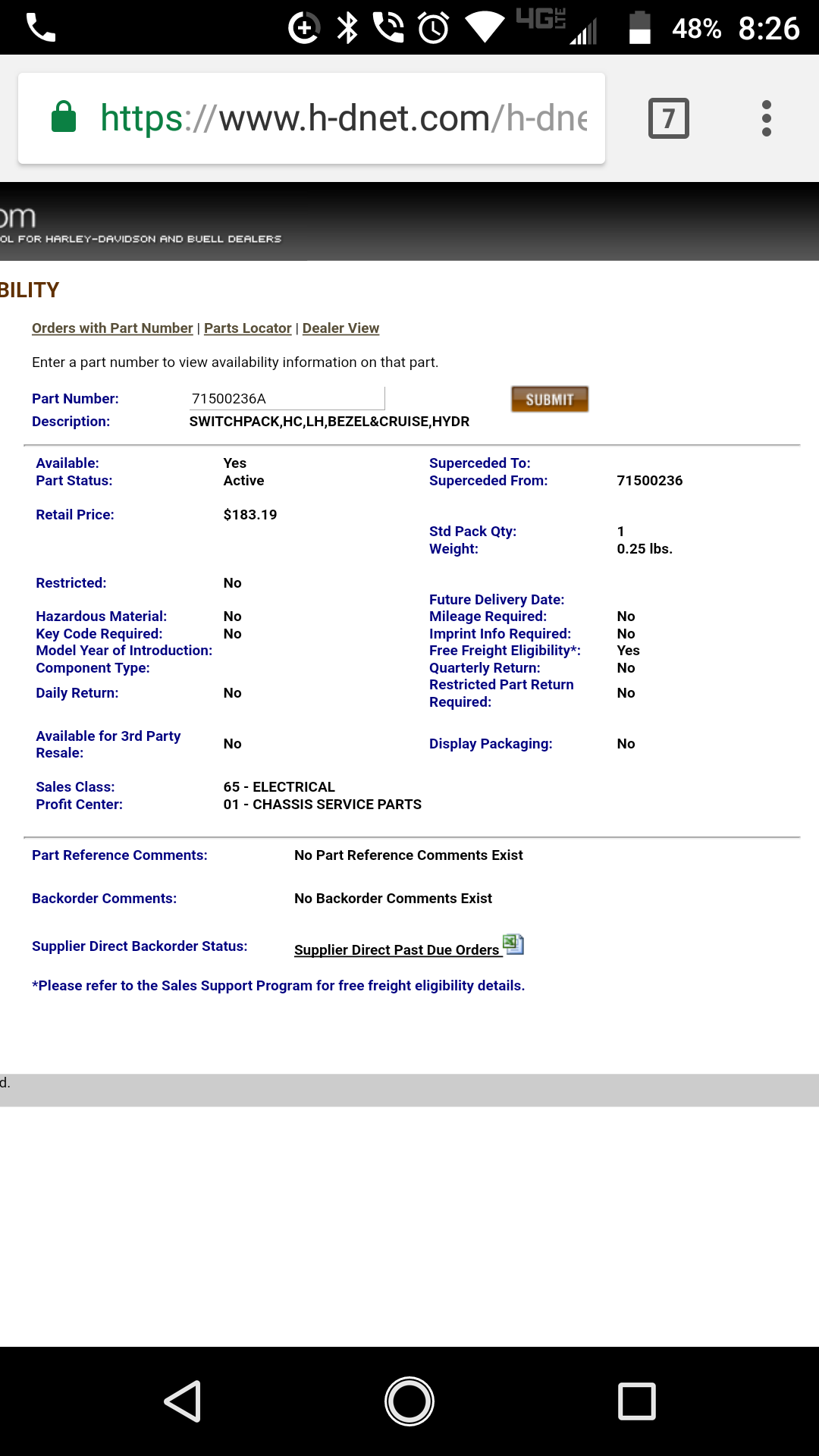

probably not what you wanted part number wise, and no we didn't pay a dime!
Sweet just what I needed. Part number is on there.

sometimes the part numbers on the R.O. cross reference or correlate to something else from the P&A but hope that is it
It's the correct part number. My dealership doesn't have it.
